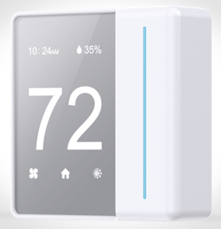

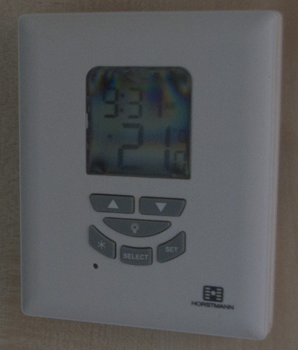

I have already had problems with wireless thermostats, this one 1701992507556.png seemed great on the spec, but slowly lost it's RF link with base, and could fail on, so it was rather useless, so having been bit once, I am a little nervous just reading the spec, also caught out with the Nest Gen 3, was told it would work with Energenie Mihome TRV heads, and it does not. I have found a review for the Tapo 1701993133094.png but the review here does not say if wireless, and I can't find a single advert selling them. Pity as have the Kasa TRV head.

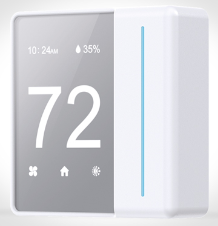

I have already had problems with wireless thermostats, this one View attachment 324283 seemed great on the spec, but slowly lost it's RF link with base, and could fail on, so it was rather useless, so having been bit once, I am a little nervous just reading the spec, also caught out with the Nest Gen 3, was told it would work with Energenie Mihome TRV heads, and it does not. I have found a review for the Tapo View attachment 324284 but the review here does not say if wireless, and I can't find a single advert selling them. Pity as have the Kasa TRV head.

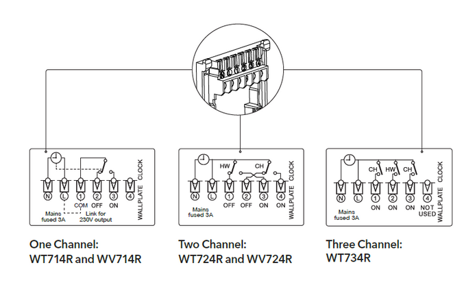

I have re-looked at wiser, not sure how I would wire it 1702033036074.png the version I would need would be this
which leaves a problem, would need relays so 1 would go to motorised valve main house and relay, two would go to boiler, three would go to motorised valve and relay, the relay would power the central heating, and the motorised valve would power the pump for that part of house. So quite a bit of rewiring. Plus £242 for the thermostats, plus £52 each for the TRV heads, and I have 13 of them. That is not what I call cheap. The single channel running alongside the Nest is still nearly £100.
So Drayton Wiser is £36 more expensive to Hive for thermostat, but only £2 more for the TRV heads, I will admit the Wiser is looking good, as a single channel version with the Nest, I think I will talk about it with my son, as I am getting to the point where likely he will need to repair it.
