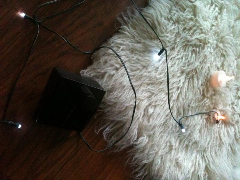

I'm guessing the LEDS are very similar for power consumption. Maybe 0.1W each led? (they aren't very bright). So the power source should power 0.1Wx100 bulbs and I was running 0.1Wx51 bulbs. The last bulb being the tealight.

Is it possible that overloading this with power would stop it flickering?
You cannot overload an item with power, but you can overvolt the item which may then result in the item taking too much power and being damaged.

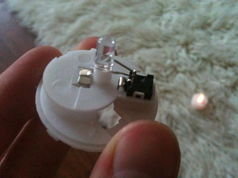

You may have destroyed the chip in the tea lights by an over voltage and the drive to the LED has gone short circuit. What happens if you re-fit the battery ?
You will need to regulate the voltage from whatever source you choose to be the same as the battery voltage when the LED is on. Some low cost items will only work with the type of battery supplied as they rely on the battery voltage dropping as current is taken from the battery, ( batteries have internal resistance which creates a voltage drop inside the battery when current is drawn from the battery )
did you measure the supply voltage?

I can tell you that when I took away the solar power current and replaced the battery, it flickered as normal.
I will open up the solar panel and see what battery is in there for its output.

In my mission to power these £1 tealights I was hoping it would be cheap and simple. When I find out how many volts are reaching the tealight with its battery, vs with the solar panel (using 95 leds already) will that answer my question of why it doesn't flicker without the battery? Could it be something more complex than, since it has too many volts, this is overloading the flicker circuit (or making it flicker so fast it appears on permanently).
