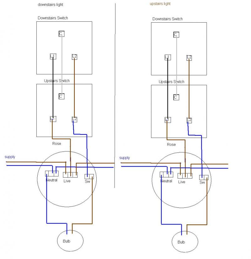

check my 2 way lighting please :)
4 May 2009
112
3
Surrey
just trying to work out the wiring for my 2 way lighting for my house. There is a double switch upstairs and a double upstairs. From these i want to turn the upstairs light or the downstairs light on from either switch.
Please excuse any wrong colours!
Ideally the blue switched lives should be sleeved brown at the terminations.
Also the black and greys in the switches should have brown sleeves.
thanks chaps,
I did know about the brown sleeving, I just omitted it from my drawing for my own clarity.
and yes, I did mean upstairs and downstairs!
