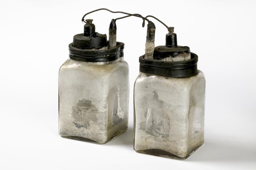

You don't say what type of cell, I remember my CSE physics exam, being asked about a Daniel Cell, and I had never heard of one, seems used to calibrate voltmeters.
We still run experiments using Leclanché cells,

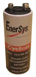

And cyclon cells! :)
