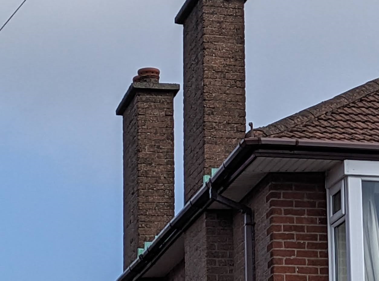

Hey everyone, just an update on a problem that bugged us for years, which I hope might help others here.
We have a large chimney stack (the rear one in the picture - sorry for the quality, had to crop!) that was causing water to leak into the room below during heavy rain.
For YEARS we tried to solve this. Had multiple attempts with different roofers. And many quotes from guys quoting everything from £80 to £7,000 to repair it. In the end, we spent a few thousand in total and had all of these works done:
1. Fully repointed
2. Reflashed and flashing edges sealed with lead mate
3. Reflaunched
4. Clay cowls and base of pots sealed
5. Entire stack treated with storm dry cream
I was up on the scaffolding myself with the last crew insisting that they re-do some of the work because it was far from neat. It was only after I got them back a second time and they followed my instructions that the job finally seems to have succeeded. We've had some very heavy rain since the work was done (in spring) and no detectable ingress in the loft or room below.
A huge relief. I'm hoping this continues through the winter.
What I will say is that, because the chimneys aren't in use, and I would like the roof re-felted and re-tiled one day, I think we will eventually have this stack taken away. YES we could have just done that already but I was so determined to fix this! It seemed ridiculous to me that fixing a leaky chimney stack would be so difficult, and it became a bit of a mission.
Hopefully this story may help anyone in a similar situation - and yeah, if you have the option, just removing the stack might be the better path for you!
