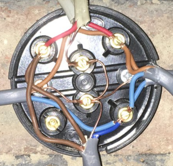

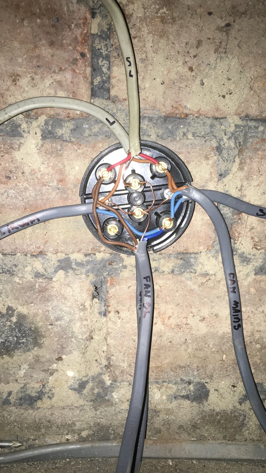

    Wiring up one of these for lighting/extractor fan. Never really use them so wondering if I'm better off with a proper wiring box & strip or if this will cope alright.
    I'm feeding it from a 3a spur to comply with the extractor mi's then has L to fan, l/switch & onto next light. S/L from switch then going to light & extractor.
    Will the choco box cope alright with this or will it be too much?
    (Earths still to be sleeved never had any to hand)

    What's a chocolate box?
    The picture shows a traditional 20 amp 6 terminal junction box.
    The most I have dared to connect to one of these 8 cables. Would never recommend more than 8.

    I've just always known these as chocolate boxes
    This has 7, wasn't sure if electrical guys doubled up on the holes.
    I'm fitting a light in the living room since there's not one in there so one of the cables will be going into another box to deal with the wiring for that.

    Seems ok AFAICT.
    Would recommend leaving all the wires the same length, around 2 - 2.5 inches.
    You see, the very short wires may break off at the ends, meaning there's zero slack to re-terminate without having to start again.

    Might just do that, it's in a false ceiling & I've left plenty excess for cables but anything to make life easier in the future.

    While you are at it, invest in some earth sleeving. Those bare earth conductors need covering up!
    [​IMG]
    PS
    Your picture is a junction box. These are what is commonly known as 'choc block'
