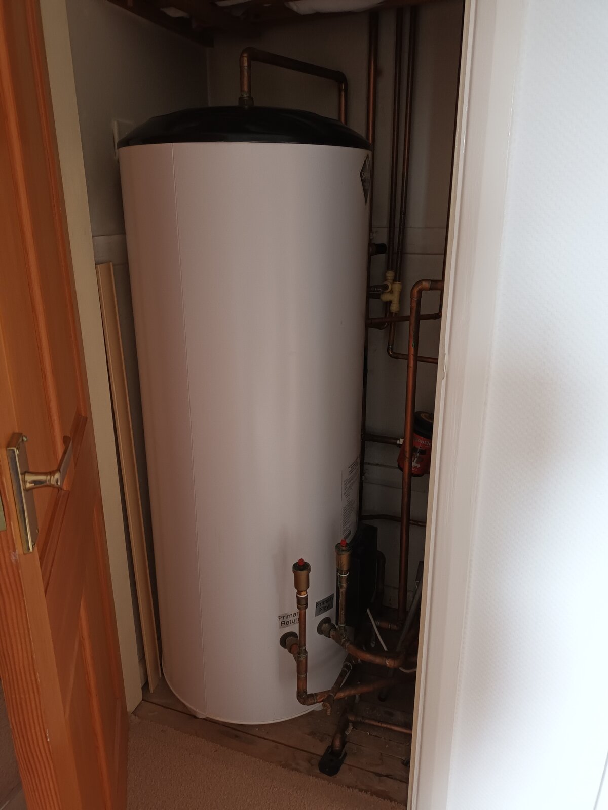

The pressure of your hot water makes a difference. What colour is your cylinder?
With luck, a 1970's or 1980s house will have a 20mm or 25mm plastic water supply pipe, black or blue. Does yours? Older houses often have metal pipes of small diameter that do not deliver a good flow.

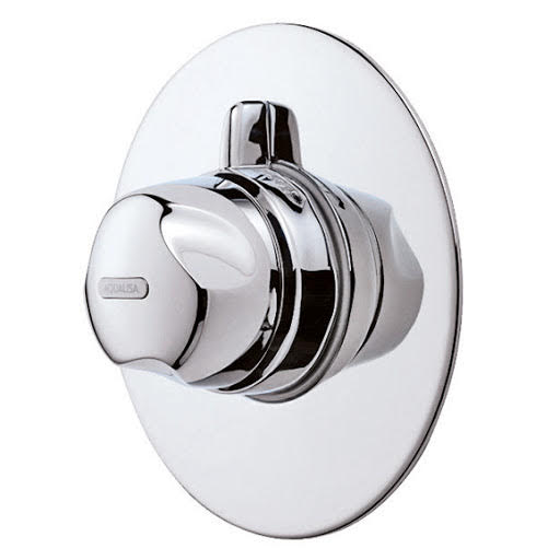

Opinions will differ, but I have been extremely pleased with the round-bodied Aqualisa mixers. The design is very good, and they built their reputation on it. Spares are easy to get and they are simple to maintain. They also now offer more complicated electronic models, but I think the round-bodied is the most dependable.

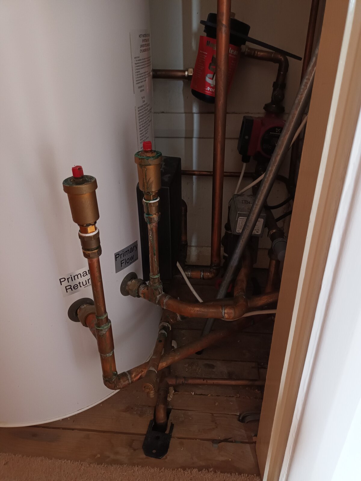

Thanks so much. This is the cylinder, cylinder pipes and shower. It seems that the pipes to the cylinder are big copper ones so assume 25mm. Pipes to the toilet and basin appear to be 20mm copper ones, so I am assuming the shower in there is too. I cannot check as pipes are in the wall.

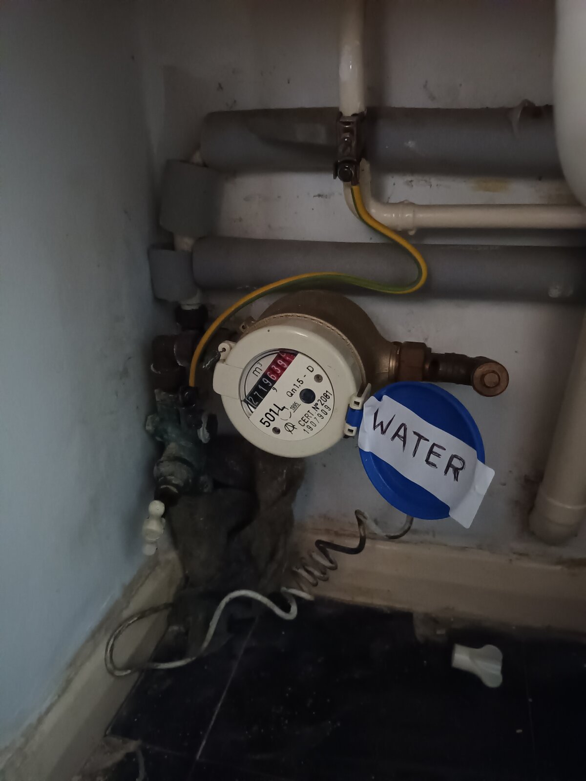

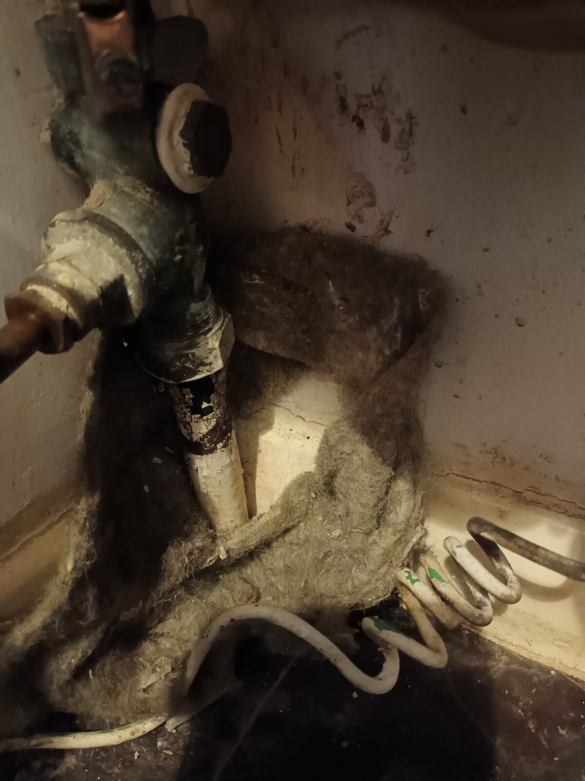

I cannot seem to find the incoming mains pipe to confirm the plastic pipe size. Plenty of wastewater but no incoming found yet, but the garage is full of junk so maybe hidden in there.

Yes, the Aqualisa round-bodied has a particularly good thermostatic mechanism.
The incoming pipe will be visible at your stopcock, and possibly at the water meter if there is one, though you may only be able to see new pipework dating from the meter installation.

This is an example Aqalisa, there are various colours, prices and designs, but the round body is the key point.
Ah, the white cylinder is a high-pressure one, supplied from the mains water pipe. These can give unsurpassed showers, provided that the pipework is big enough to carry the flow. It will probably have a date on a label, but it looks pretty good to me. It's what I would have suggested. Due to be high pressure, it needs to be checked, and if necessary serviced, by a qualified person. Your boiler repairer probably has the qualification, but ask.
Measure the flow at the hot and cold bathtaps, they are usually sized to give the best flow available.
The copper pipes are more likely 22mm and 15mm (plastic pipes measure bigger because they have thicker walls)

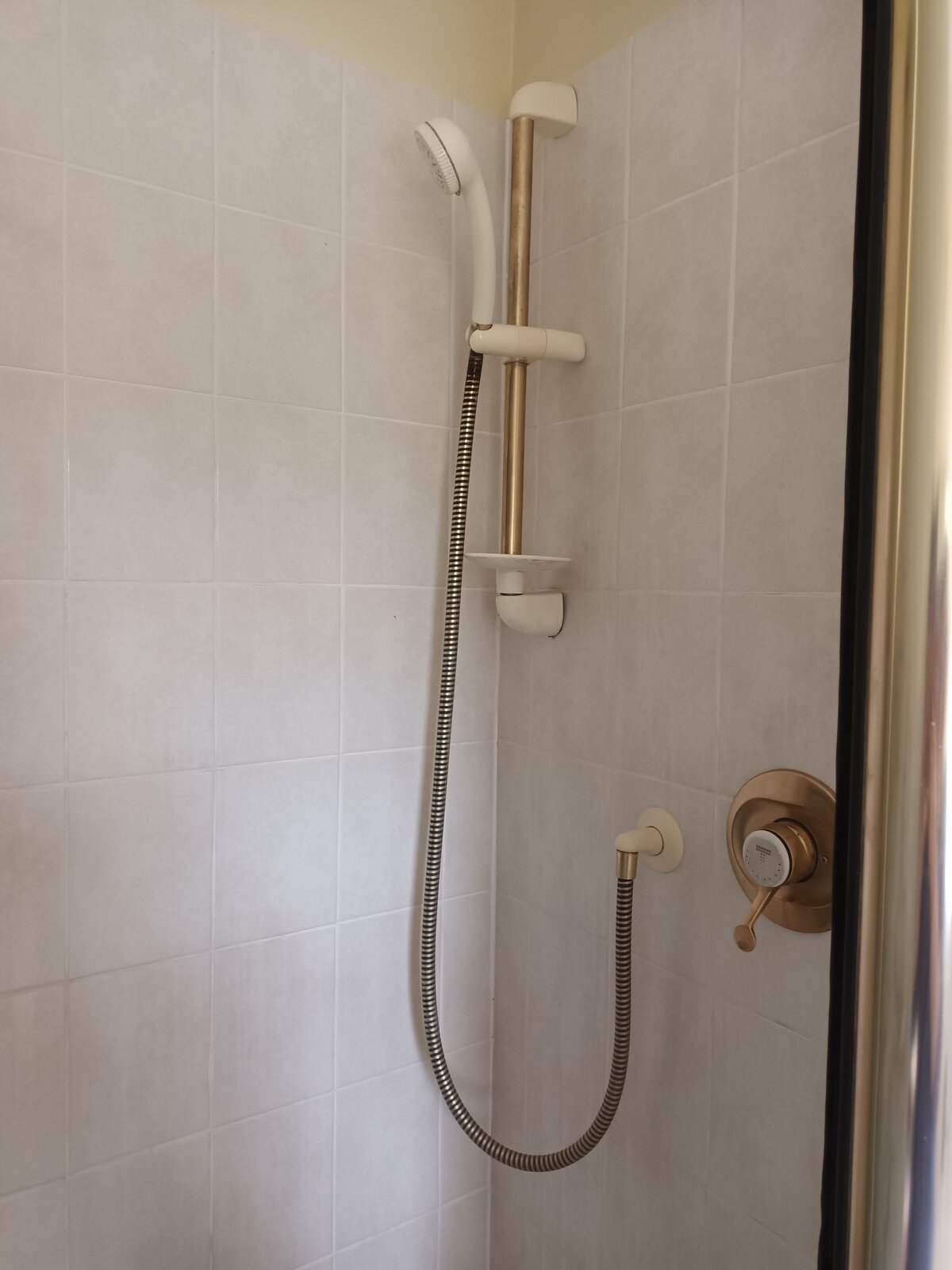

I don't recognise the mixer, but it may already be an Aqualisa, or possibly a copy brand.
Looks like the previous owners of your house bought good stuff.

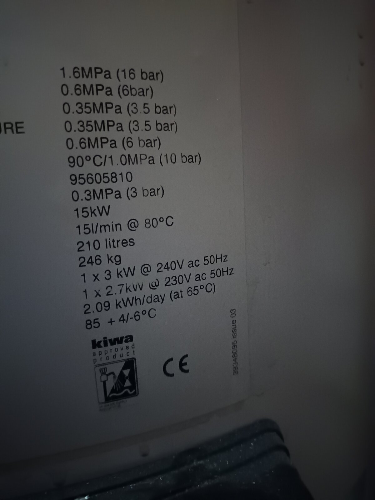

Great thanks ever so much. I will try that for the flow rate. The cylinder says 210 ltr unvented indirect. I assume this is the stop tap at the water meter. The first photo is the spec of the cylinder.
Yes, it's the pipe coming out of the floor, but I can't make it out in the pic. Is it a concrete floor?
BTW 210 litres is an excellent size. A typical bath holds about 100 litres, including cold. The modern cylinders are so well insulated that it loses very little heat.
It's asbestos tiles, crysolite, we had it tested, assume concrete under them. buts that's another joy we found in this house! We are leaving that well alone if we can.
That T on the shower mixer valve handle looks like the Trevi (from Ideal Standard) logo to me.
Ideal Standard are a decent enough brand, I believe.

You can easily recognise the ones with the round body and thermostatic cartridge inside.
