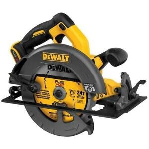

You might like to know that I can happily cut 4 x 2s in wet timber with a cordless 18 volt saw fitted with a 20 tooth blade (about 450 watts equivalent) - something I do regularly - so a 1350 watt mains power saw should eat a 4 x 2.

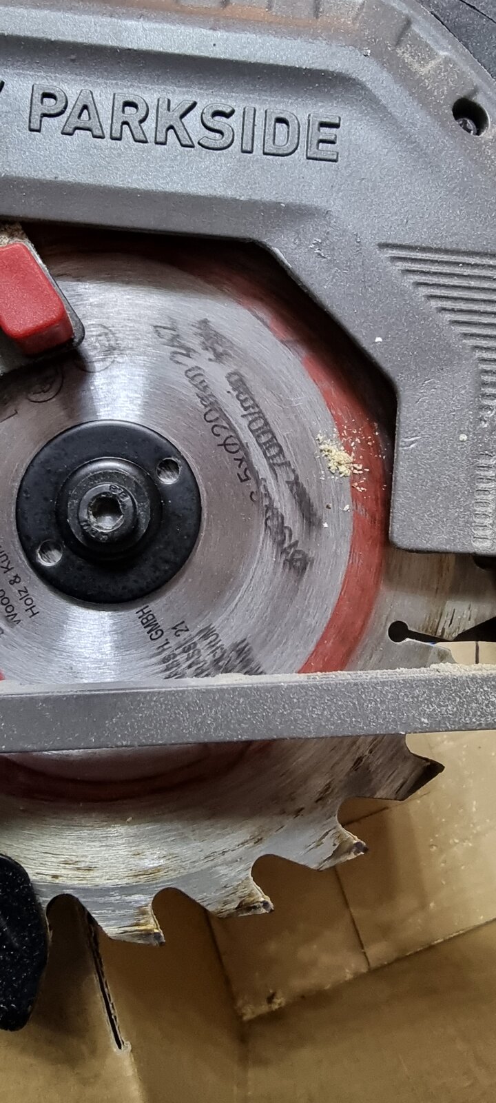

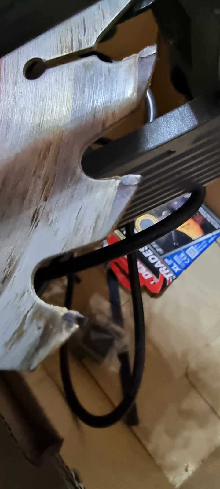

Apologies, I thought I had replied. I did cut the 10mm and 25mm woods with ease.. attached are the pictures of the blade. Perhaps it's a poor quality blade after all..
I might be mistaken, but it looks as though you have at least one broken tooth on that blade (the bottom most one) which indicates contact with metal at some point in a cut. I suggest you replace the blade with a 190mm diameter x 30mm bore 24t blade - something like a Saxton or a Dart blade. Keep the gash blade for doing floorboards

It's just the photo, the teeth appear to be OK.. but you may be right, there may have been contact which I'm not aware off.
