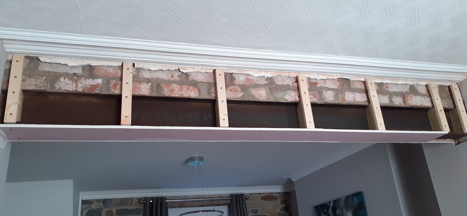

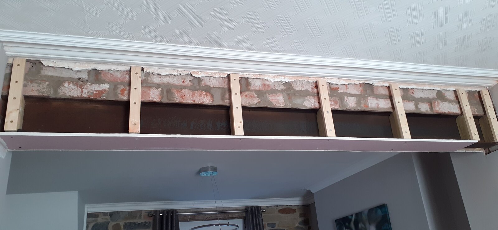

BC were happy with one layer of fireboard on mine, albeit for regularisation of an existing beam.
Edges and joints were filled with intumescent sealant.
Did you also clad that face that's unclad ATM? As that's a classic example of what's been accepted for years through lack of knowledge, in a fire, the timber will expand and twist and buckle against the steel, as the screws heat up they'll char the timber they're fixed into and can fail too. In reality it'll probably all be OK seeing as it's in a house but really it's not right.
Yup, that was a work in progress shot.
I have a feeling BC wasn't that bothered about anything!
He came around for a roof change and we added on the regularisation, as he was here :)
