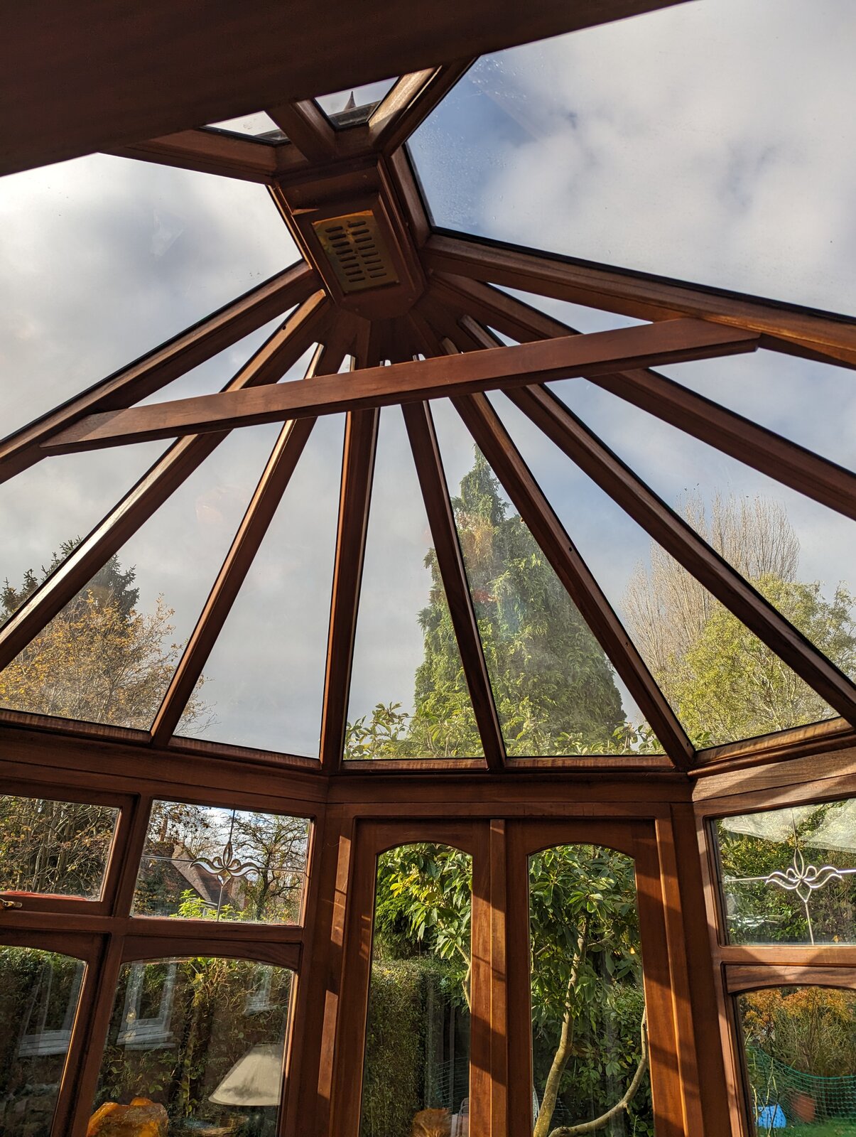

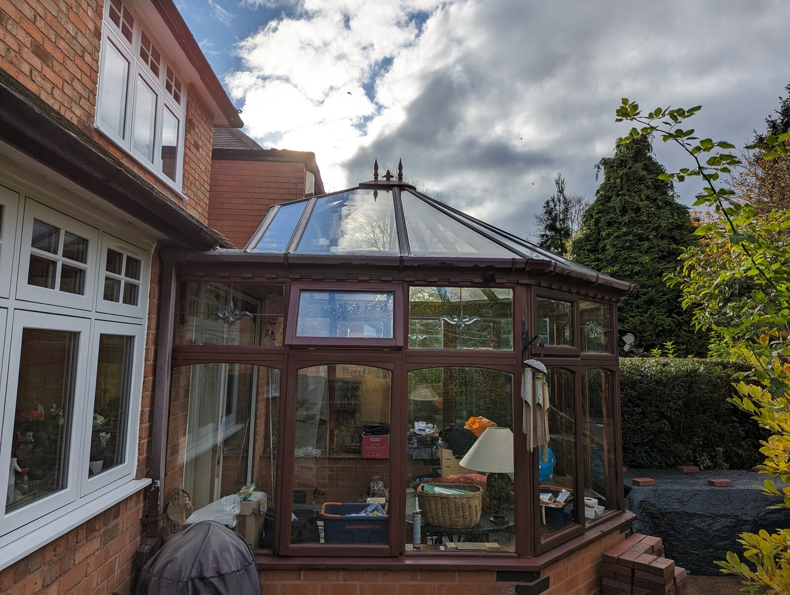

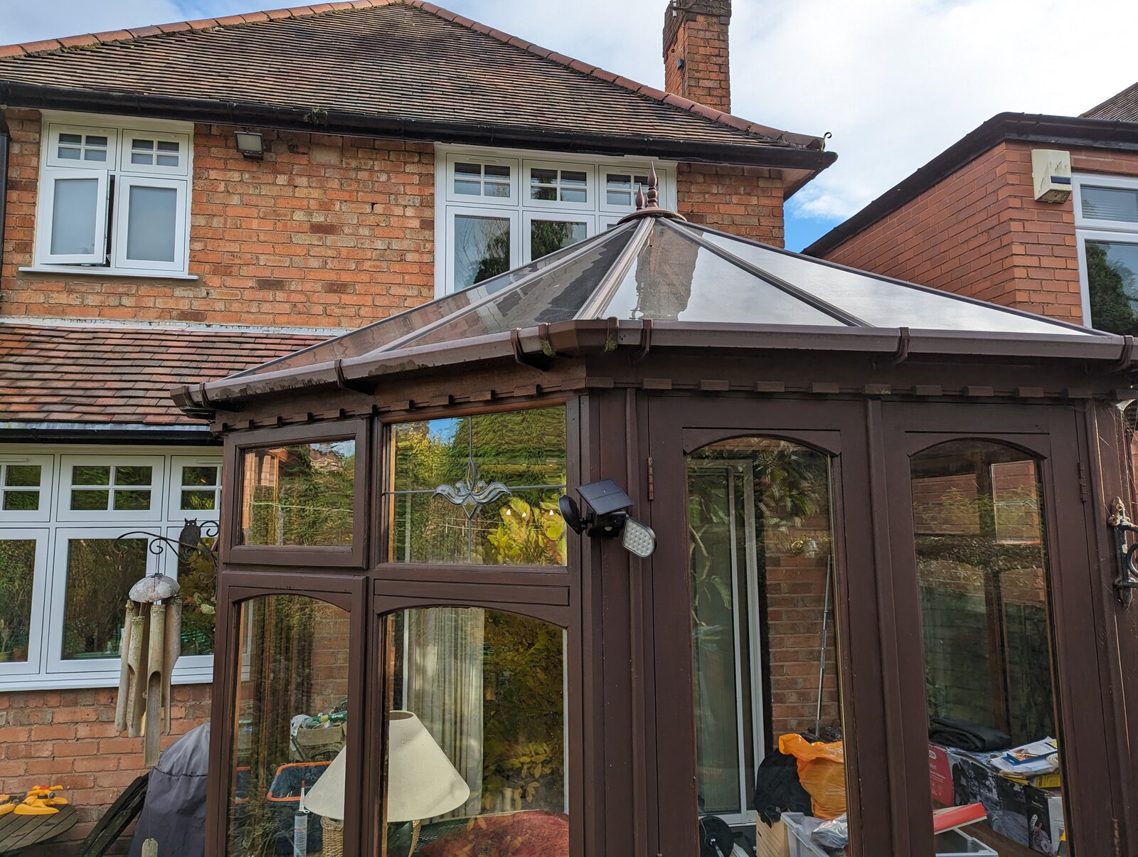

Photos attached. Plan was to mirror the existing roof shape, but bring the roof line slightly lower.
Not sure I would be wanting to keep that style wise, but then it would be a shame to get rid of it because it does look well built.
Yeah I agree. Basically we've got a baby on the way and this is the cheapest way to get some more space, as it's currently only usable 2 months of the year.
Personally I hate conservatories but it does look well built so it would be a shame for it to sit there unused or knocked down.
If you want the room to be warmer, it's not just the weight of the tiles to consider, you'll need insulation and plasterboard under that lot too.
Even then you'll have a room that has all the walls made of glass, it will still be costly to heat.
If you want an extension then put the money towards an extension, otherwise you'll be putting lippy on a pig and you'll end up with a crap extension that doubles up as a crap conservatory.
