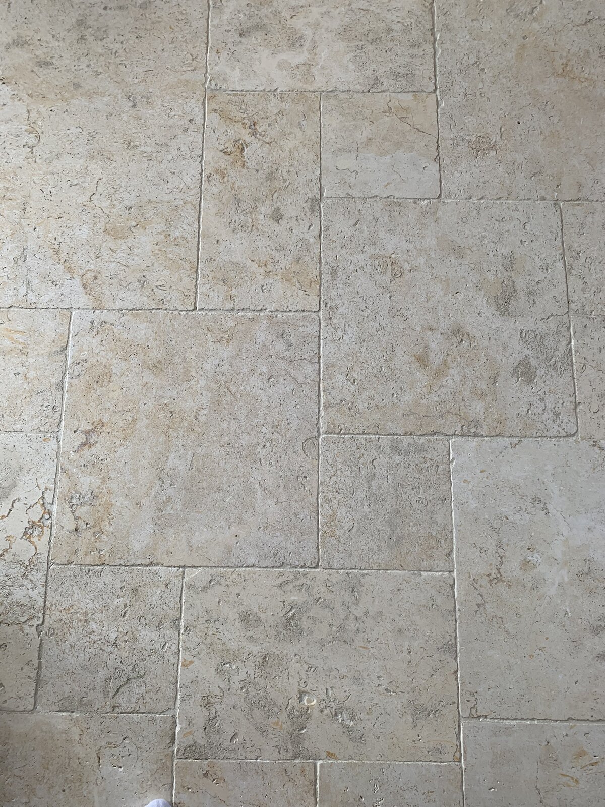

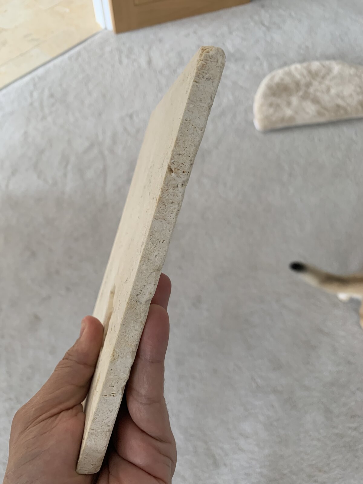

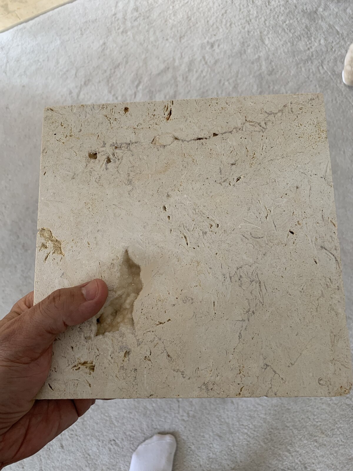

Hi all,
we moved to a house last year where ground floor is mostly natural stone. The tiles could be limestone or travertine but I'm not sure so I attached a few pics.
In certain areas (e.g. around the kitchen island) the floor & grout is darker (dirty). Is there any way to clean & seal the floor?
I wouldn't attempt to do that myself so if anyone has any recommendations on competent professionals in Kent that can do that sort of thing it would be great.
thank you
I clean mine with a rotary floor scrubber then can be sealed with a wipe on sealer available from any hardware supplier.Easy diy.
I use a weak solution of PH balancer ( used for pools and hot tubs) which restores the grout nicely.Apply to grout only and leave wet overnight.
