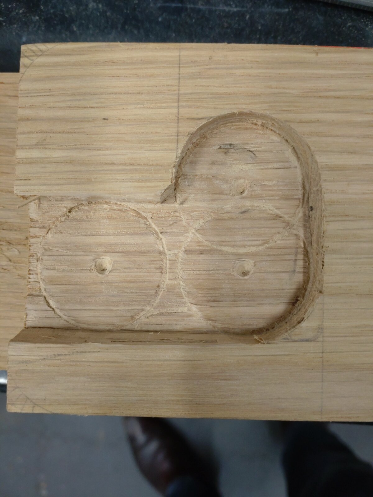

I had a go at making a kitchen towel holder from left over wood. I shaped the rebate with a Forster but and then attempted to tidy up with a chisel. I don't think Paul Sellers has anything to worry about at the moment lol!
I was surprised by the size and depth of the lip and centre point. Is that part for the course or have I got a poor design of bit?
How would you tidy up? If I use a chisel it'll be hard to keep the curves. I was thinking of buying a top bearing flush cut router bit and seeing if that was quicker. This oak is much harder to chisel than softwood.
For the future is making a router template and pattern bit the only way to go, or is there a better method with hand tools?

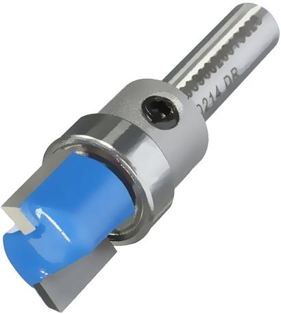

The centre point extending downwards is, I'm afraid, par for the course with Forstner bits, and generaally even more so with lower cost tools which generally have more prominent and somewhat blunter centre points (I assume from the photo that you aren't using a Fisch or Famag bit). Without it the bit will tend to wander off line at the start of the cut, however the result is that you can always see the "dimple". If you are drilling a recess to take a piece of hardware that will occupy the entire hole this isn't an issue, but if you want a true flat bottom recess the way to go is to make up a template from 18mm MDF or plywood (using the Forstner bit and a jig saw) and then rout out the recess using a top bearing cutter like this one in a plunge router:
That is all of a fiver on Amazon, and they won't last long, but they are good enough to do a few jobs. The maximum depth of cut on these is only 10mm, so the first couple of cuts (no more than 6mm depth each) are made with the template in place and then if any more depth is required the template is removed and the existing opening is used to guide the cutter (always going clockwise on the inside of a shape). Now that you are where you are I'd suggest that if you have at least 7 or 8mm depth you get a cutter like this and use it to clean-up the bottom of the recess, but making a new template as well will allow you to clean-up the edges of the recess which do appear to be a bit ragged. Templates can be hot melt glued to the workpiece, or just pinned to it with panel pins - then removed by the use of a chisel to break the two apart
Trying to do that with hand tools will require chisels, gouges and possibly a router plane to boot.

Yep, that's what I thought. Looking at my picture. Where the rebate comes to the edge of the board. I took out the bulk with the Forstner. Then I scored along the grain on the face and the end grain with the chisel. Then I started to chisel from the Forstner hole towards the edge of the board. But at the edge of the board, you can see in some places the board has splintered and the bottom of the cut is too deep.
TBH a job like that is far easier to do with a router, a template and the right bit than it is to do it by hand
