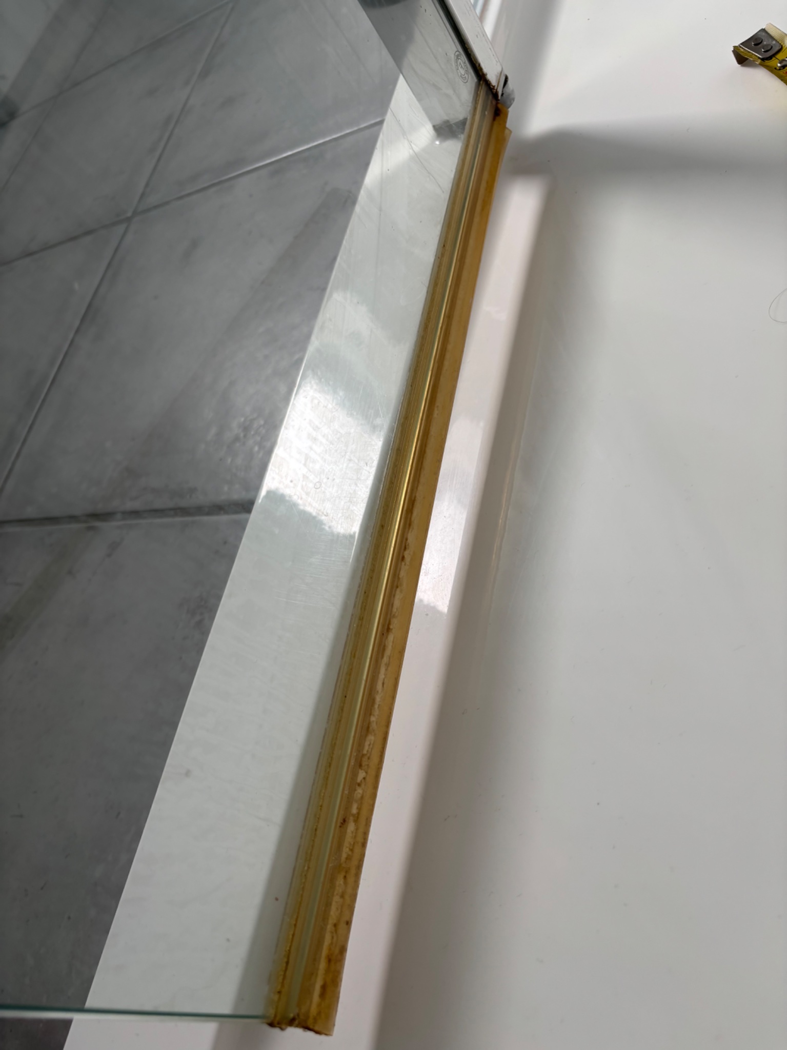

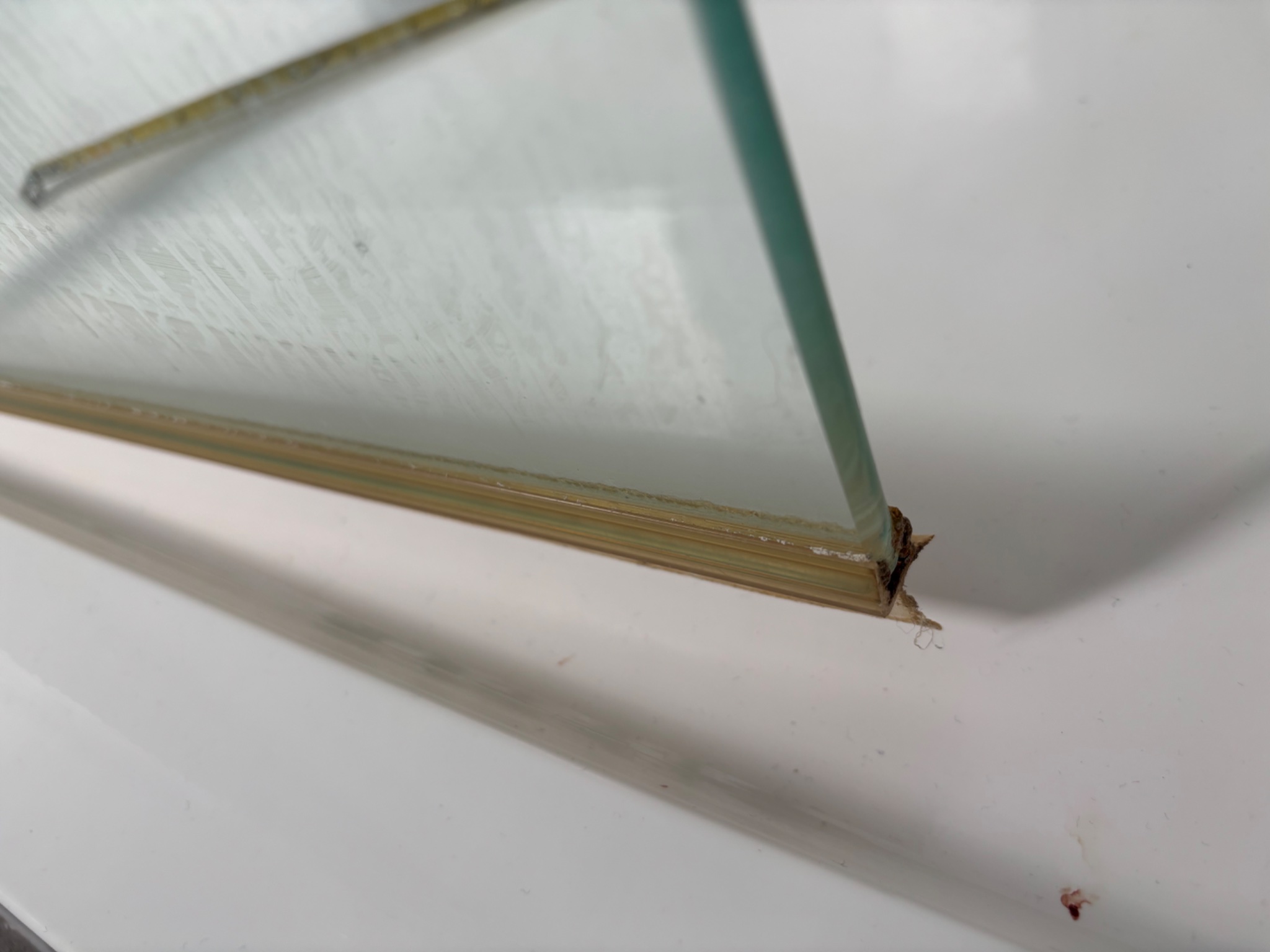

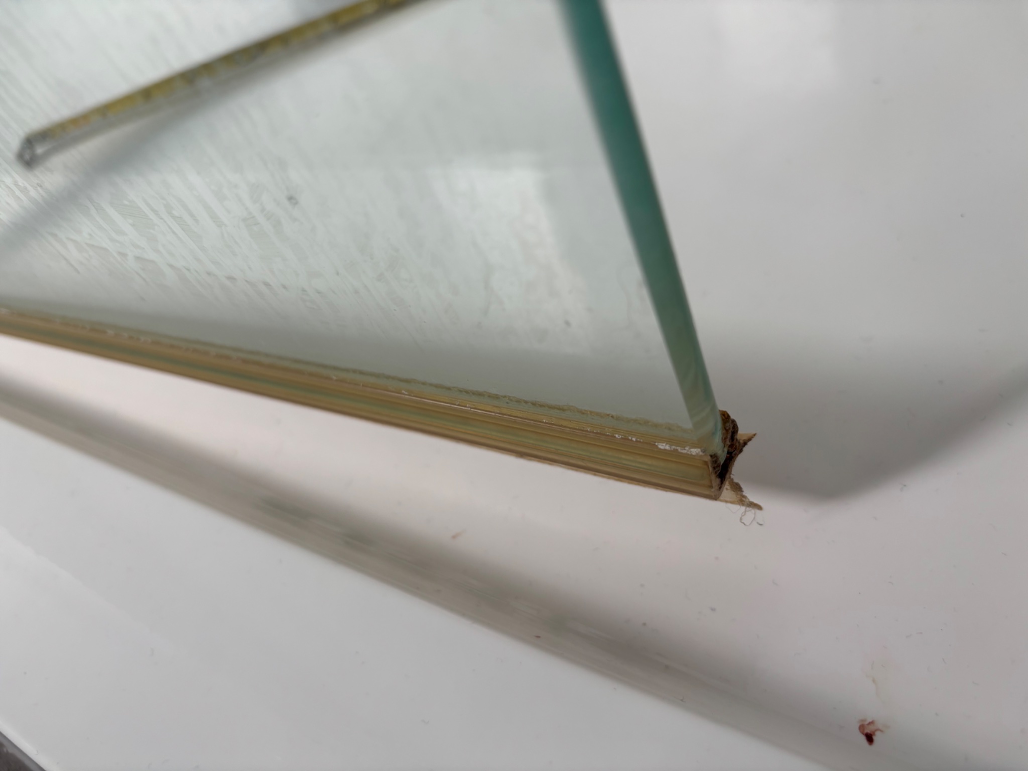

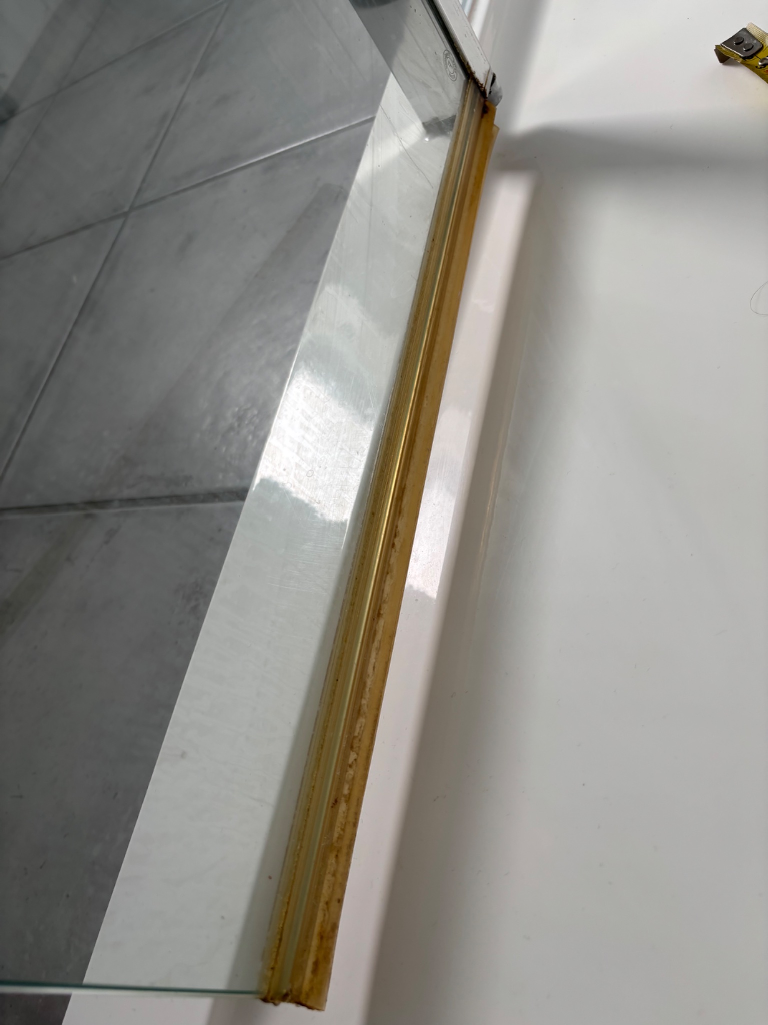

Hello
What’s the best way to remove limescale that’s built up around a shower screen seal that I plan to replace? Scrape? Use a cleaner? Knife?
Cheers

I've had good results by mixing white vinegar and washing up liquid in a spray bottle, and leaving it to dwell on the screen for a while before rinsing and wiping.
The washing up liquid stops the vinegar from just washing straight off.

Brick acid would work, but would be too aggressive. :cool:
We tend to use this stuff for kettles, wet zones etc...
What split 50/50?
We use a hand held steam cleaner on ours, brings it up like new.
ANY descaling bathroom cleaner (not toilet cleaner, it's too strong and might affect finishes). Don't use brick acid or other random acids, it may remove the finish from the bath. Spray it on without wetting (for maximum strength), wipe it around, wipe it off then repeat if necessary. Then wipe away with water. Polish with glass cleaner after to get rid of the smears.
