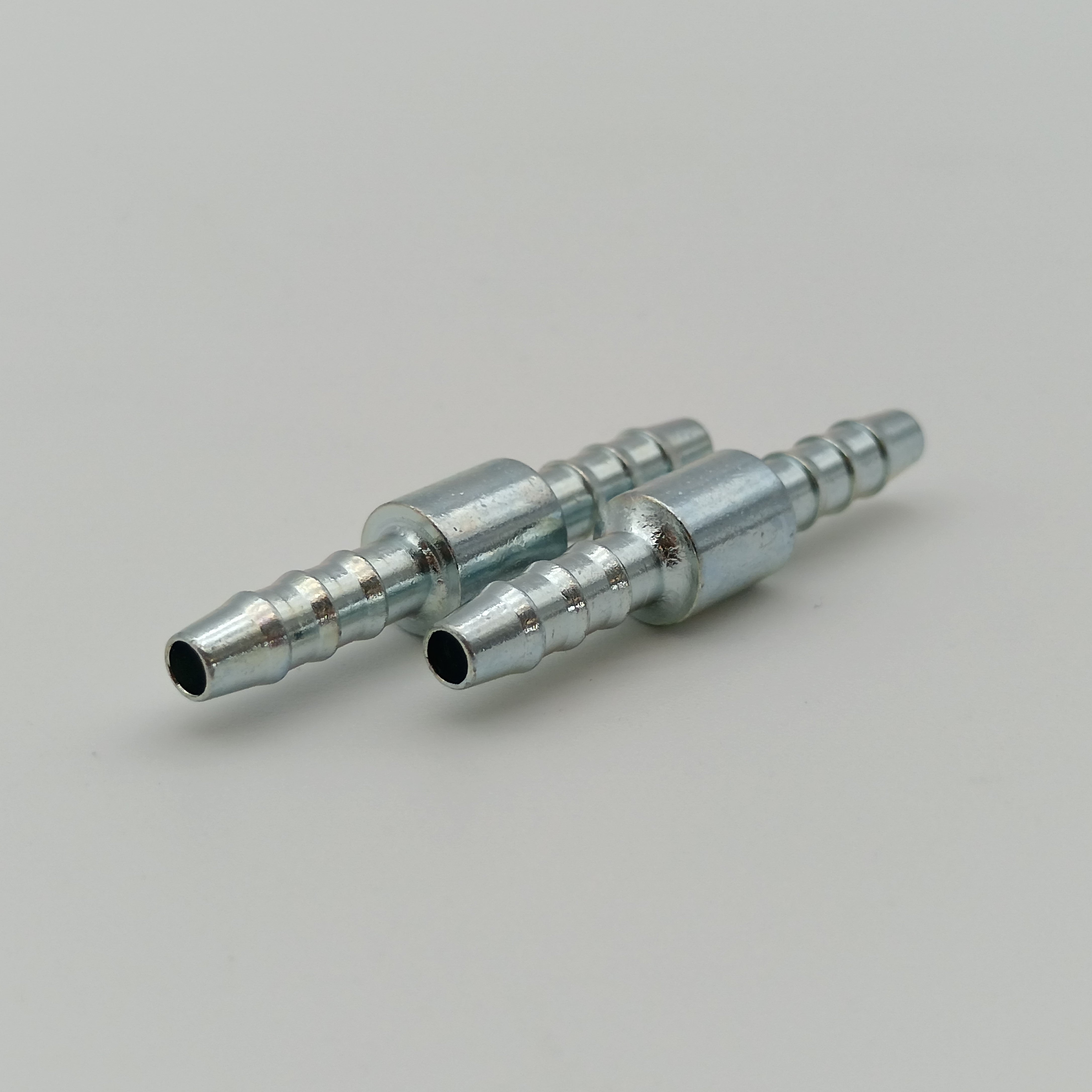

No problem at all. The hard plastic tube is probably polyamide (nylon). Should be good for up to about 100 PSI of fuel pressure. Is it petrol or diesel? A couple of years ago, my son bought a non-runner on eBay (fuel leak). It turned out some idiot had jacked it up and trapped one of those hard plastic fuel lines. We cut out the damaged section and stuck one of these in to join the cut ends:
Not cheap, but they're OEM quality fittings.
No hose clips needed. HOWEVER... there's a knack to doing it. You need to heat the polyamide tube (more here if you need it):
with a hot air gun to JUST below melting point, and then push those connectors in quickly and squarely. Not enough heat and the connector won't go in, it will just kink the tube. Too much heat, and the tube melts! Needs to be about 110 degrees C, so dipping the tube in boiling water won't be enough.
Once in, the tube cools and shrinks around the barbs. It will NOT come off! ...EVER! :LOL:
Also, if you want to get the joiner out of the tube, don't run a Stanley knife down the tube lengthwise, as the tiniest of scratches on the edges of the steel barbs will cause a leak. You're best warming the tube again and "pinching" the plastic off sideways with blacksmith's pincers or side cutters.
