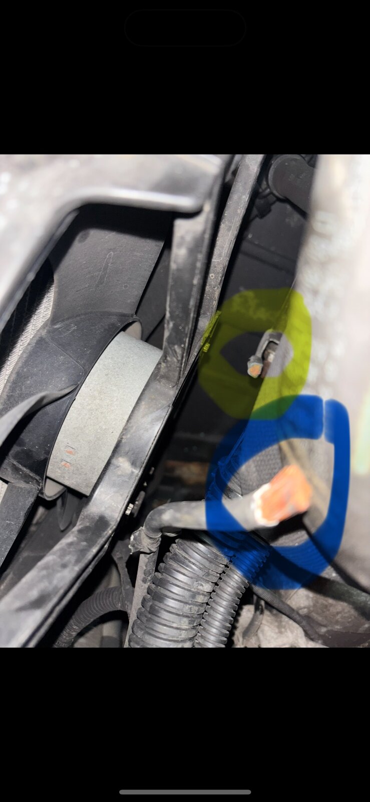

UPDATE: tracked all the earth strap wires and managed to find a broken cable going to under the starter motor area( maybe gear box area?) the copper has snapped away from the crimped connection, I temporarily connected it back up and she fired up for a brief moment! problem I have now is I’ve got to somehow connect them together, I can’t remove the bolt that hold the earth point as it’s stuck and very hard to get to! It’s 9mm wire going onto a broken off, only thing I can think off is to solder it?

You will struggle to solder that, with an iron - needs a blow-lamp. Easier to just find someone to make a new strap up, with lugs, long enough to reach to a bolt you can access. You might find in a decent parts shop, they have them ready, on the shelf.

bad earth was the culprit, managed to repair the broken lead by crimping and soldering an ring terminal and then bolted onto engine. Fires up great now.
