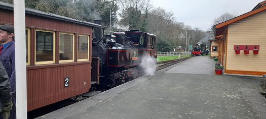

Had 40tonne delivered before Xmas, and uncle picked up a tonne of anthracite week before last.
Was burning some today
cold turkey event at local railway.

What psi does the boiler run at?
Guess being solid fuel, the biggest issue is low water, not a massive boiler so sinking time will be short.
Had to pull plenty of fires out coal fired steamers over the years.
