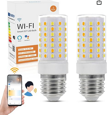

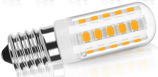

I regarded as being for display, seen them in pubs, often need to take menu outside to read it as light so poor, and the cob LED 1767696814308.pngreverse, it does not look very good, so in the main I fitted the pearl LED bulb 1767696949883.pngwhich basic shines up from the base, and the cover defuses the light. But as one looks at Lumen - Watts one sees 806 Lumen from 7.3 watt for pearl and 805 Lumen from 6.5 watt filament, the cob 800 Lumen from 7 watt, but in general the cob design can allow a larger bulb to be fitted, from 7 to 18 watt seems common, where the other two seem to be lower wattages. The smart version seems to be pearl type, although did find these 1767698308880.pngwhich show an impressive 7W 800LM, but expensive at £15 each.

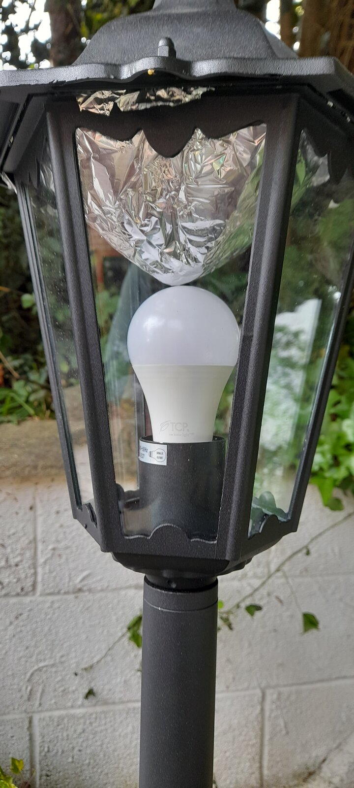

However, it seems the LED is moving on, but the light direction is also changing, I look at this 20230518_174342.jpg attempt to redirect the light from a pearl bulb, I reversed the tin foil after, I wanted a smart bulb, so I could switch in on before leaving the car, and the smart cob bulb is 3 x cost of pearl at the moment. However, it seems things have moved on, and we now have the option of bulbs which shine 90° to base, like the old tungsten bulb.

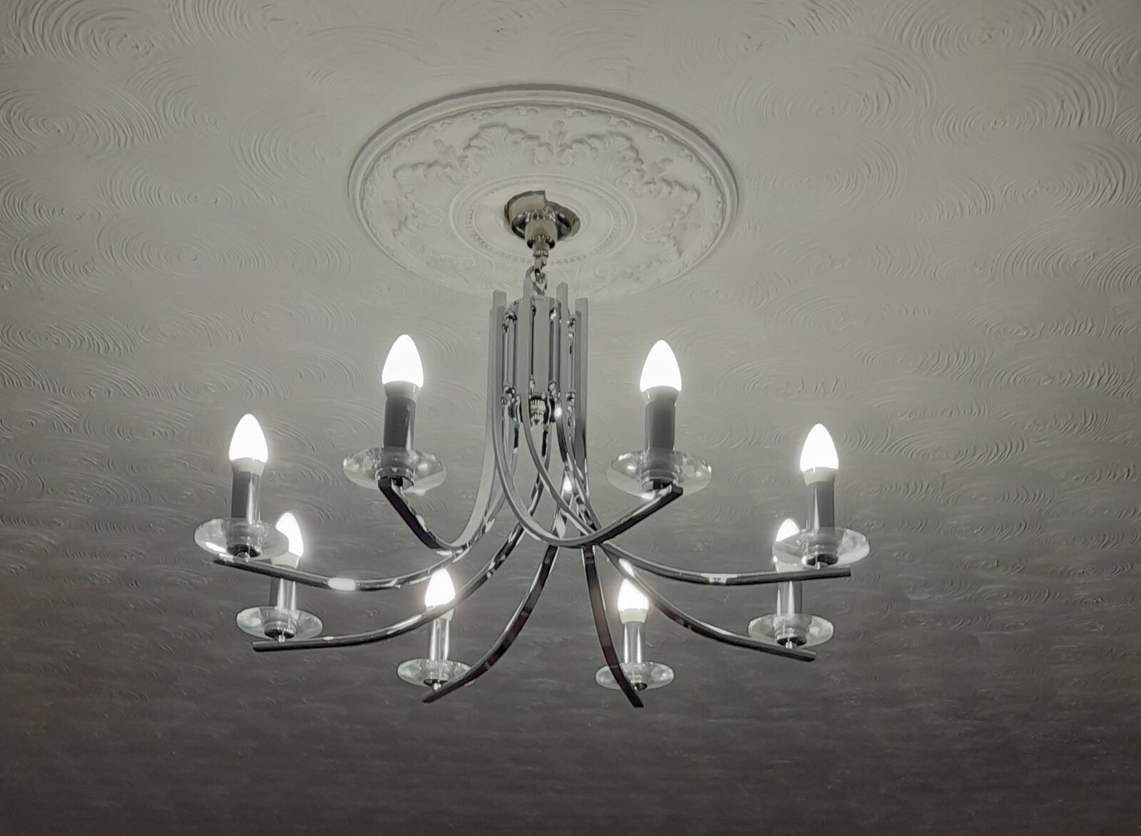

I look at the chandelier Ceiling light.jpg got to increase light output as only one lamp in the room, which is still not really enough, so we use standard lamps, and display lights to supplement it, and wonder what 8 x E14 filament type LED's would do to room lighting? But hunting for bulbs found a lot of 4 watt versions, at 400 lumens, and some adverts could not find the lumen output.
But has anyone changed to filament bulbs, and if so was there an improvement in spread of light?

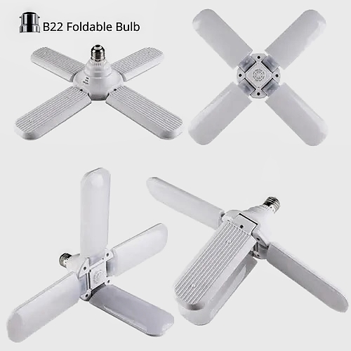

yes, filament LED's can come in low output versions, but they don't have to! You can get bright ones too! Their main advantage is when you want light to come out the sides.
If you want light to some out the top, go for the traditional LEDs ones

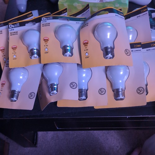

While not filament, these are good for a 60W replacement. 330° light output.
If you want more than one, just ask her how many you require and she will sort it.
filament ones use less watts, but cost more. Think I prefer the above

I've not tried those yet, I'm not inclined to, the examples I have seen, they are only decorative. I tried a couple of cobs, but they seem to overheat far too easily, and commit suicide. Most of what we use are these 20230518_174342.jpg, but I'm careful to ensure they are well ventilated, for cool running. Other than that, I use fittings, which are complete with integral LED.
