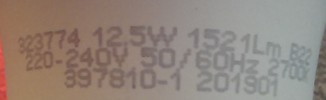

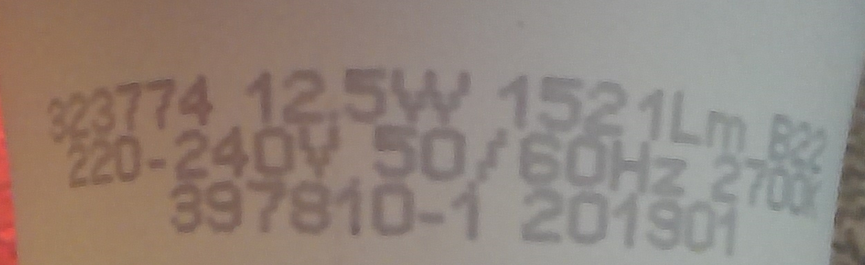

1766250283070.png Is it a failed standard bulb, or a smart bulb turned off. Reasonably sure this one is a failed bulb, as in the main watts x 100 for a smart bulb is more than the lumen, but for a standard bulb it is normally less than the lumen, so this one going in the bin.
Replacement 806 lumen and 6.5 watts, filament type, it says less lumen as the bulb it replaced, but seems to light the room far better, giving off an all round light. And a clear glass bulb, not frosted plastic. If made Jan 2019 not done too bad. Google does not help.

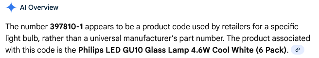

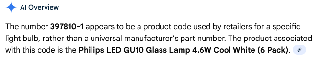

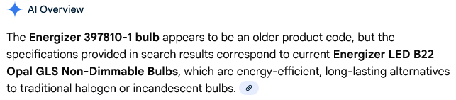

But this bulb is B22d, so the number tells one nothing. Add make and yes
That seems to be the bulb, and not smart type, but don't want to hunt every time a bulb fails to find out if failed or simply turned off in the bulb.

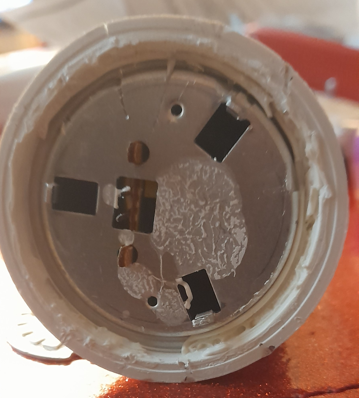

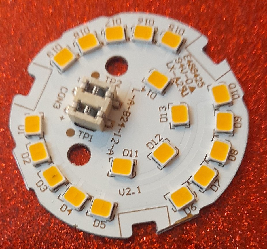

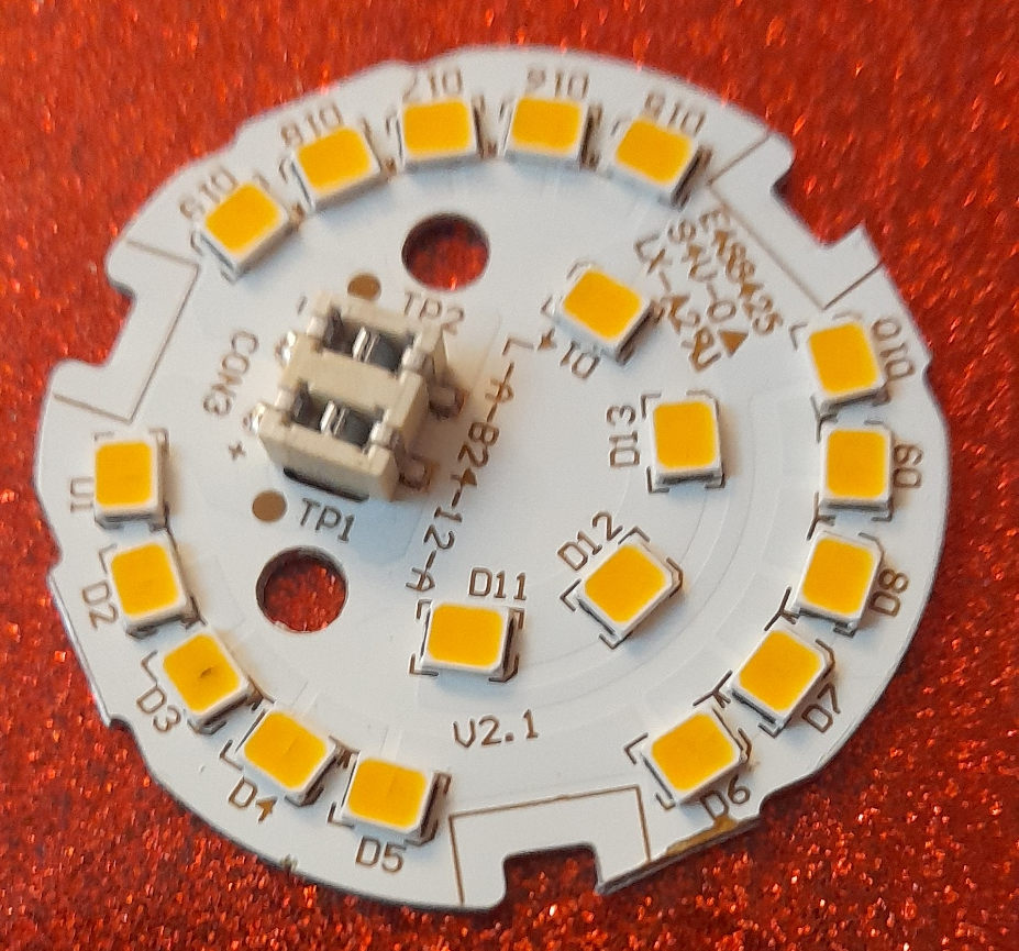

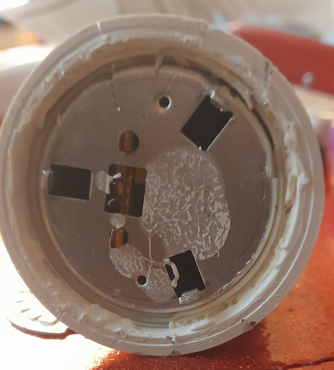

1766272712376.png1766272750806.png I found the plate was far simpler, but failed to open it further to find what was under the heat sink.
I assume there must be a capacitor and rectifier under the aluminium plate, but it clearly was not a smart version.

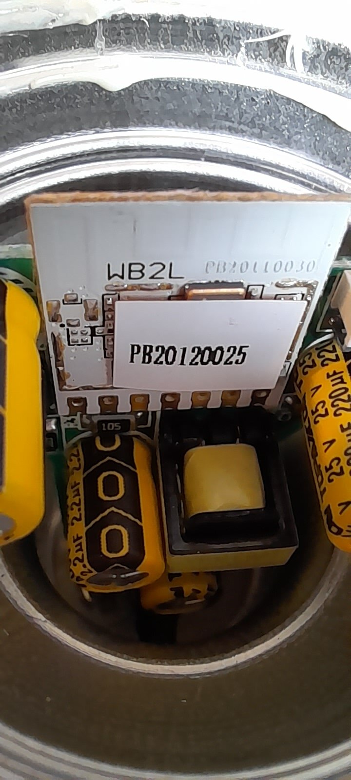

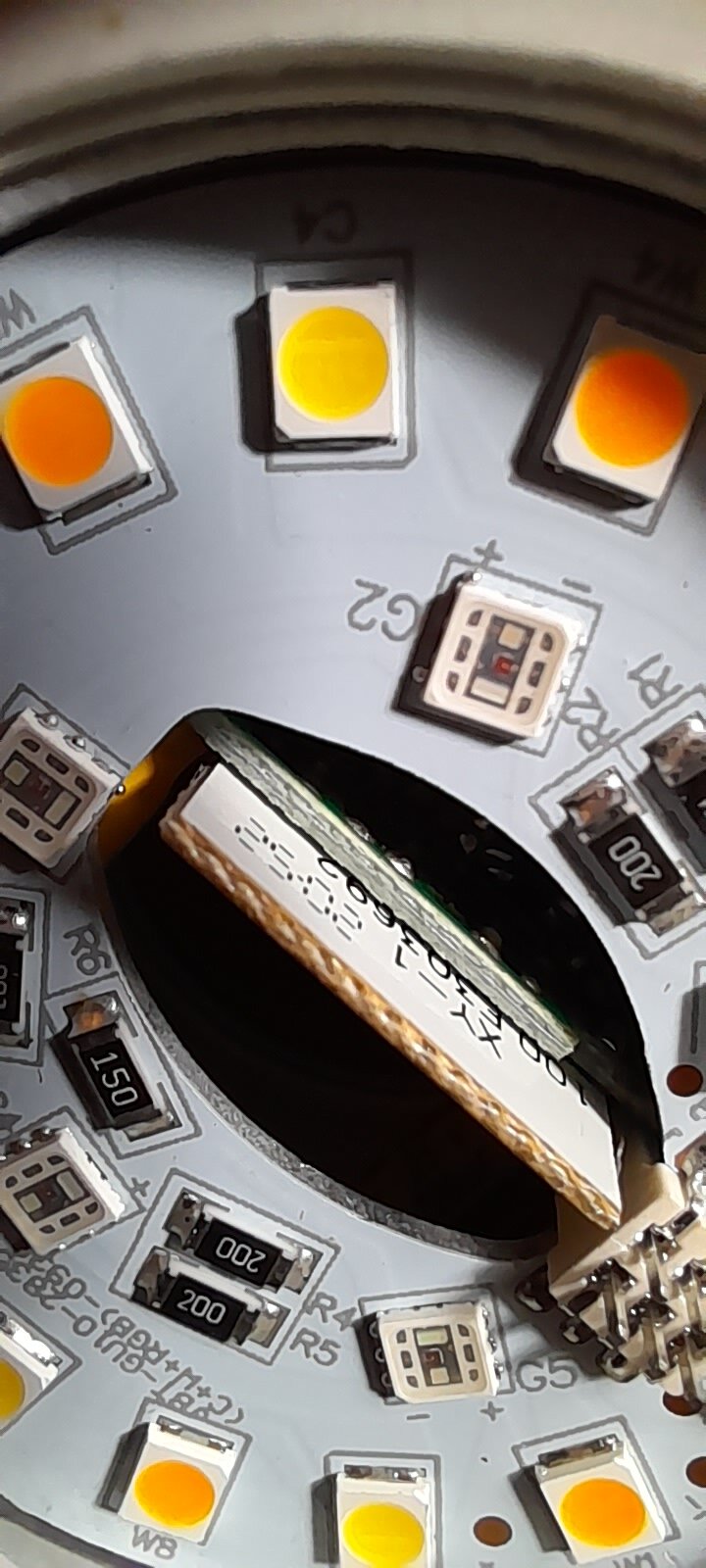

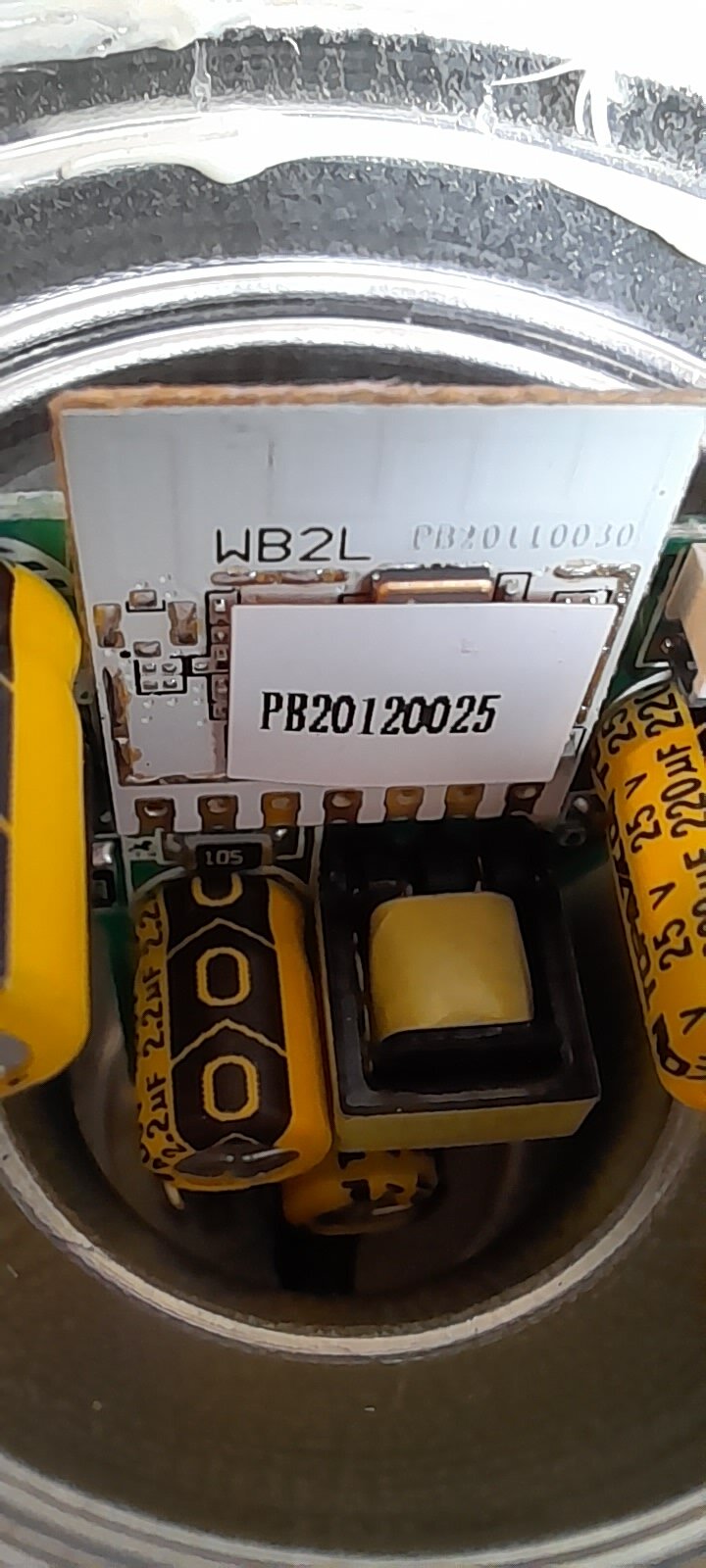

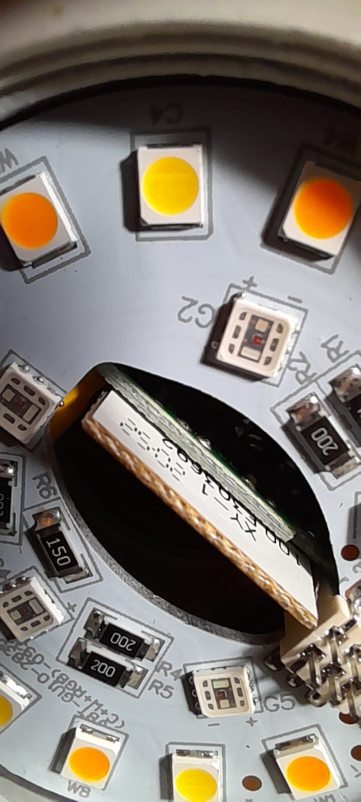

This however, this 20220603_113222.jpg20220603_113820.jpg was a smart lamp and far more complex.

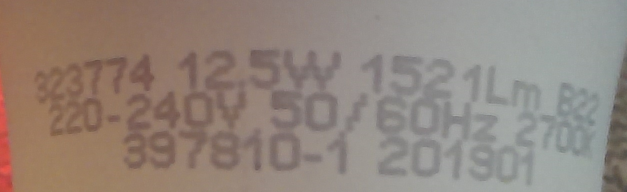

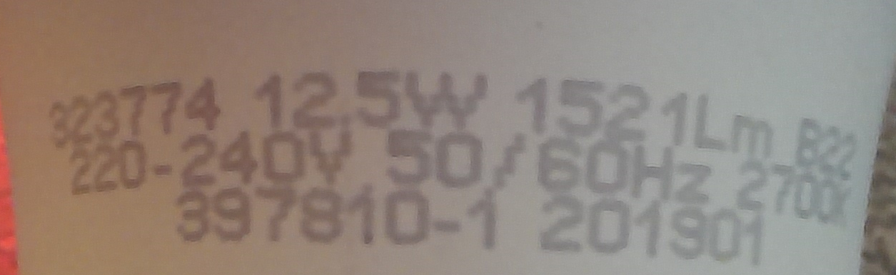

View attachment 402663 Is it a failed standard bulb, or a smart bulb turned off. Reasonably sure this one is a failed bulb, as in the main watts x 100 for a smart bulb is more than the lumen, but for a standard bulb it is normally less than the lumen, so this one going in the bin.

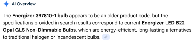

But this bulb is B22d, so the number tells one nothing. Add make and yes View attachment 402669
