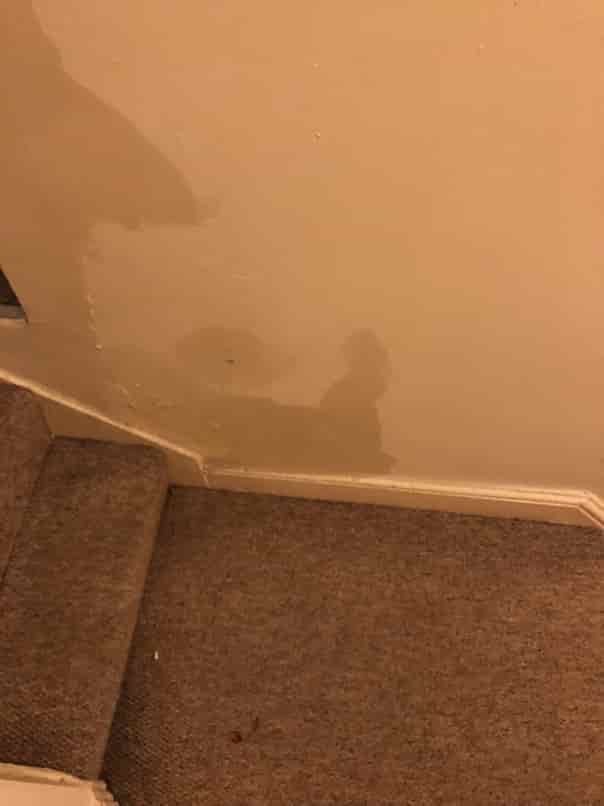

Cold spot or something else
26 Dec 2022
40
No pics from outside as terraced house . Otherside of wall would be neighbours internal wall. It’s upstairs on landing .
Sorry don’t know what you mean . If it was ? Just wanted to know what different scenarios could be

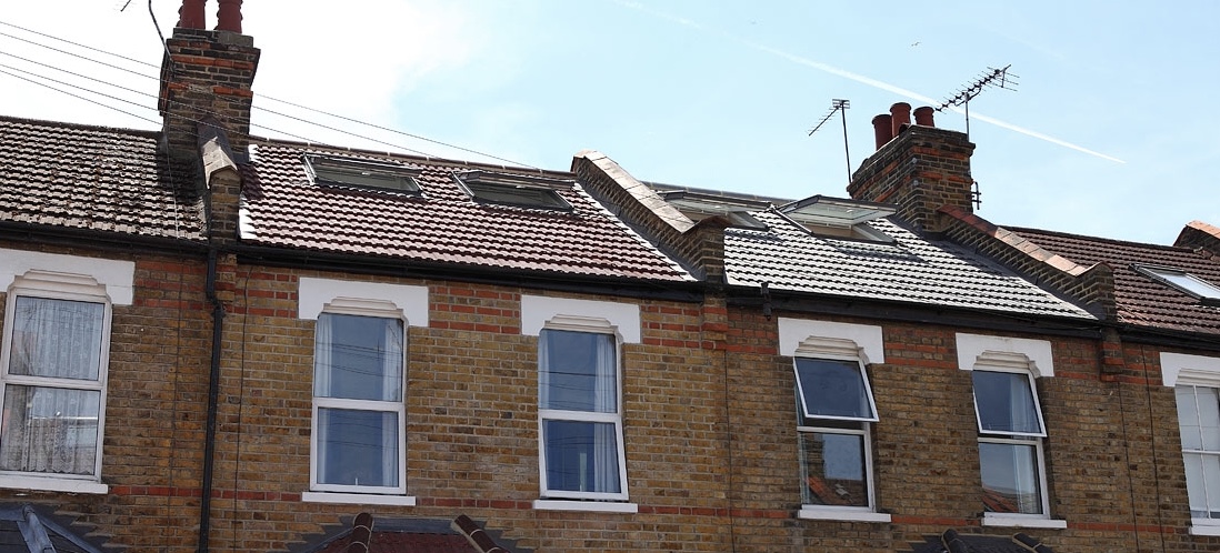

Parapet wall ( short wall above roof level separating terraced properties ) are often a source of damp issues if poorly maintained , they effectively bypass your roof weather protection allowing rain to penetrate thru the entire party wall ( wall between you and neighbour ).
Photo shows terrace with parapet walls on roof .
Thanks for reply . Good explanation too as I wouldn’t have know that . No there is no parapet wall but will double check to make sure
