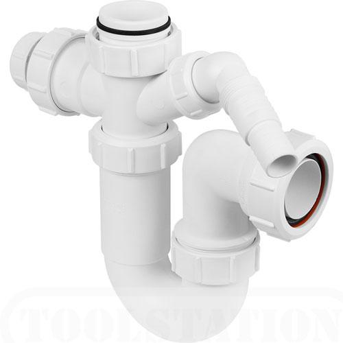

McAlpine do a kitchen sink waste trap that has a 22mm input for condesate discharge.
The combi boiler, an 8 years old Worcester 25si, has a 15mm pushfit connection for the discharge straight after the relief valve.

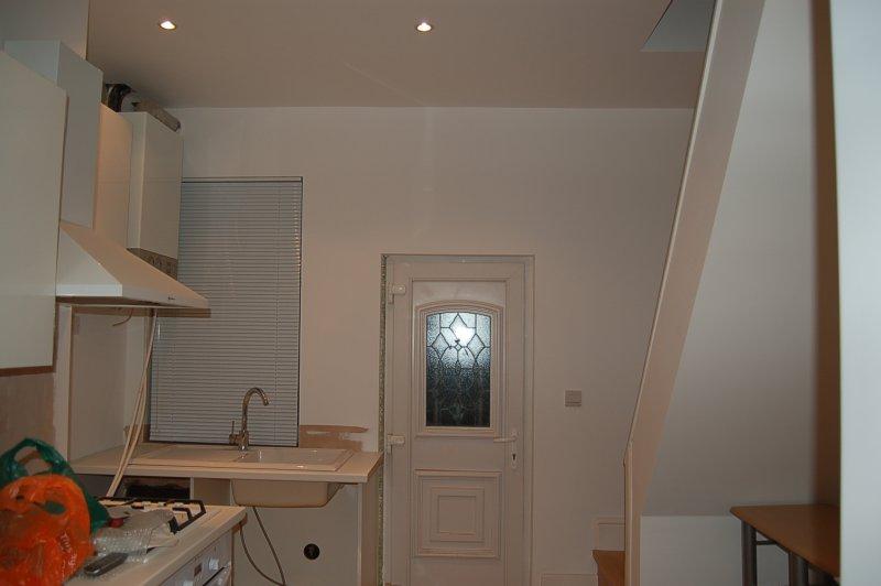

The gas fitter had taken a 15mm copper pipe straight from that to the outside of the house as the boiler is installed in the kitchen next to a window. I did chop that pipe before replastering.
As all the walls have now been replastered, instead of making another hole to take the pipe out of the boiler to the outside, could I take the pipe all the way underneath the sink and connect it with a 15mm-22mm reducer to the McAlpine trap ?
This is the kitchen layout if it helps:

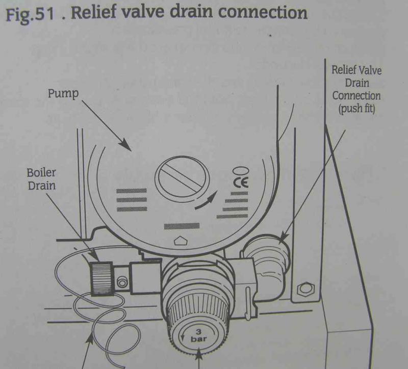

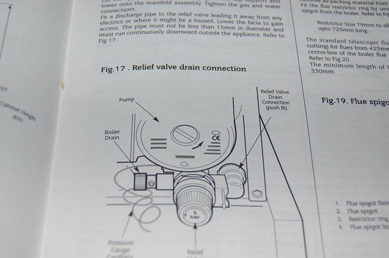

Could someone give me a definite answer please as I will have to return the McAlpine trap if I have to route the relief valve discharge outside.
This is the picture from where the pipe comes from:
and the boiler:
in detail:
Thats odd, I always thought those connections were for washing machine wastes.

Take the 15mm pipe to outside and turn the pipe back facing the wall using two elbows, so any discharge will spurt onto the wall not people. No need to sleeve the pipe. It must be soldered copper.
There are exceptions, and some safety discharge pipes can discharge into the drain. A dry HepVo trap and tundish is needed and high temperature drain pipes and fitting. These exceptions are with an Atmos appliance and in flats subject to building control.
Yes that trap has a washing machine connection, but opposite may be the 21mm condensate connection. I am not sure if this combi is a condensing model. If so then this is the trap will do, Number ASC10-CO.
http://www.mcalpineplumbing.com/productlist.asp
The condensate connection is on the side - a 21mm compression connection.
i must have misread this one YES the pressure relief must go outside the condensate can go inside
