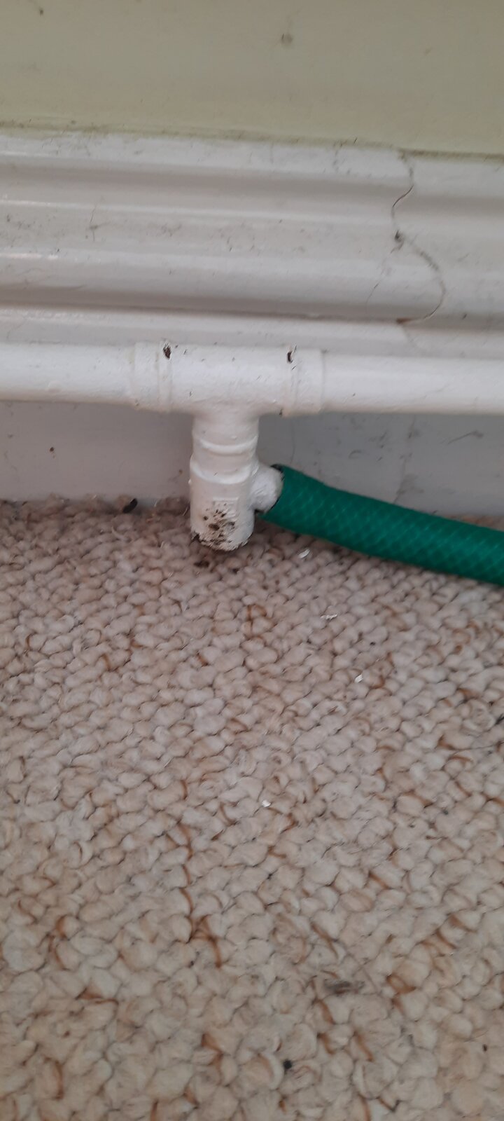

No water coming out. What best course of action, only need to drain upstairs towel rail.
I was thinking flexible bucket & drain the raid. OR remove a d/stairs rad & drain from there.
I want EASY please.
What would plumbers do.
edit
I have opened a bleed valve

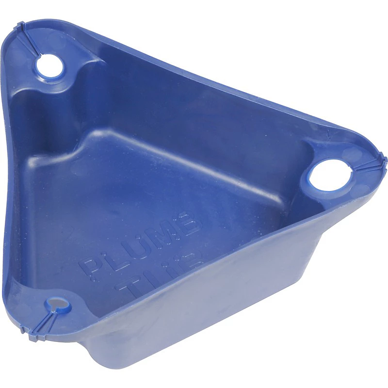

Towel rads are notoriously difficult to drain if the valves are stright and the pipework is down into the floor. Not so much if the valves are right angled into the wall. Which are yours?
Draining rads I then I use a plumb tub.
Close both towel rail valves.
Crack one of the nuts from rail to valve.
Have a baking tray or hole less rubble bag around the rad tail.
Open air vent and control flow of water into recepticle by opening and closing the air vent.
When it's empty close air vent and remove rail.
