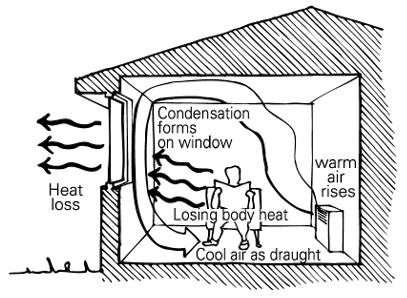

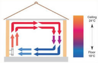

Today, we tend to use multi-thermostats, I have three in the main house, one in the living room on the wall, one in the hall on the wall, and one in wife's bedroom built into the TRV head. One could use all linked TRV heads and have no wall thermostat, but it depends on where the radiator is. Ideal would be an internal wall, so the TRV is not cooled by the outside temperature, but in the days before double glazing, we tended to put the radiator under the window, and we still see the pictures in the text books. circulation2.jpgand the air does move, circulation.jpg so the TRV head is in the best place when the heating is running, but not always the best place before the heating switches on. My wife's bedroom TRV head will turn on heating because the wall is cold, even when the room is still warm, today, clearly don't need central heating, but wife's TRV is showing 20.5ºC and living room where I am sitting shows 23.5ºC wall thermostat, one TRV shows 23ºC the other 21.5ºC and the room is a bit on the warm side, so one has to consider where to place thermostats which can fire the central heating.

Today, we tend to use multi-thermostats, I have three in the main house, one in the living room on the wall, one in the hall on the wall, and one in wife's bedroom built into the TRV head. One could use all linked TRV heads and have no wall thermostat, but it depends on where the radiator is. Ideal would be an internal wall, so the TRV is not cooled by the outside temperature, but in the days before double glazing, we tended to put the radiator under the window, and we still see the pictures in the text books. View attachment 387318and the air does move, View attachment 387319 so the TRV head is in the best place when the heating is running, but not always the best place before the heating switches on. My wife's bedroom TRV head will turn on heating because the wall is cold, even when the room is still warm, today, clearly don't need central heating, but wife's TRV is showing 20.5ºC and living room where I am sitting shows 23.5ºC wall thermostat, one TRV shows 23ºC the other 21.5ºC and the room is a bit on the warm side, so one has to consider where to place thermostats which can fire the central heating.
