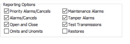

Yes, Thats right. I have another small question with reporting options
I can understand some of them
Priority - Panic Alarm
Alarms - intruder Alarm
Open and Close - ???? no idea (is it panel lid open/close?)
Omits and Unomits - omitting Zones
Maintenance Alarms - (from service interval in global options?)
Temper Alarms - Any temper from Sensors or panel
Test Transmissions - Ex- Checking Phone lines (SMS server if ComGSM)
Restores - if Panel got restore?
q1) what is open/close
q2) I am using ComGSM, if I want the system to test the SMS server path every day, should I modify Test call every in global options (in addition to Test Transmissions)?
Open and close sends a text to say you have set and unset alarm
As the gsm goes straight onto the gsm network , I wouldn't bother with the test call
