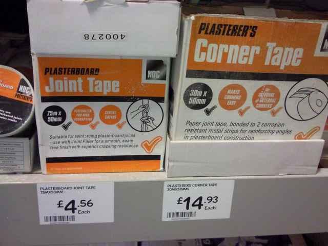

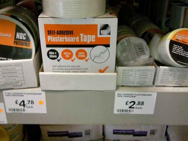

Not sure what you mean by GRP tape, but will this mesh tape do if I then coat with either plaster or adhesive:
The only other one I could find was this, but I think this is the paper tape that you advised against using:

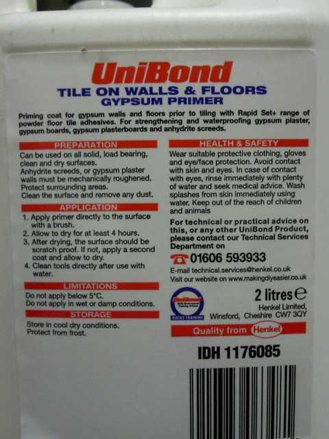

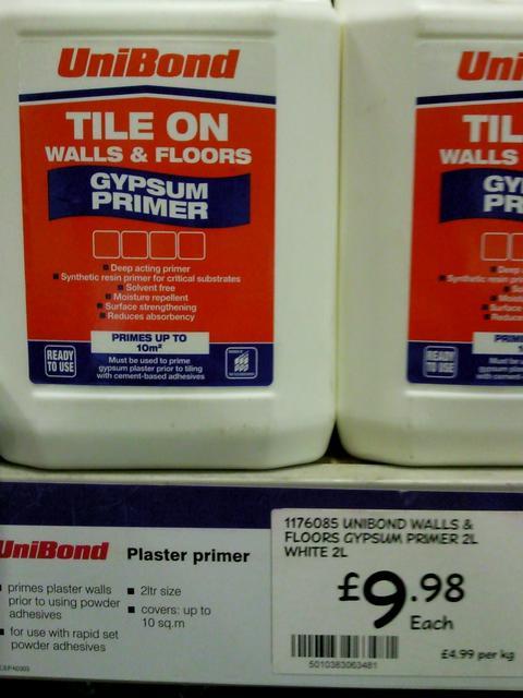

Other than at Topps I am struggling to find BAL stuff, but this Unibond primer seems to cover all the bases?
Would I be safe to assume I can use that?

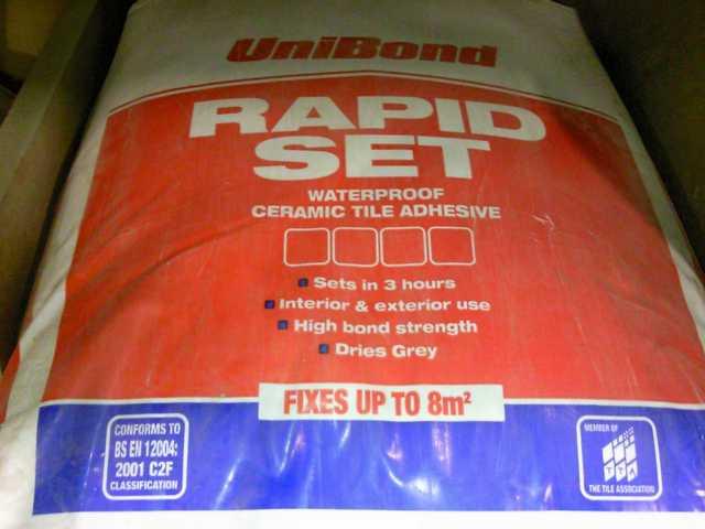

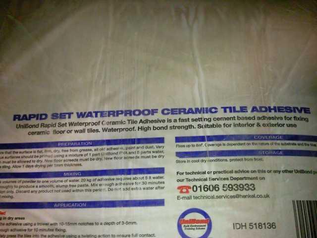

Usually greyish but colour is irrelevant; cement addy comes in a bag which you have to mix with water but be careful how much you mix in one go as it only remains usable for around 30 minutes. Tub addy is pre-mixed in a sealed tub & usually white.
I'm presuming this is the 'non disintegrating' type of 'waterproof' as opposed to fully water proof, but again it seems to otherwise cover all requirements?
So, presuming those items are all ok, I can get the tape, primer, and adhesive, but I am turning up a blank with the tanking paint, other than Topps again, (who's website says they do it, but give a phone number for ordering on).

Anyone have experience of the UniBond 'TileOn' primer pictured above?
Seems to cover both priming and waterproofing?
I can't find it on their website, but it is definitly in-store :?
That’s the one.
The only Unibond product I will use is their PVA & that’s for plastering. It’s not favorably recognised, use the search facility to see what many trade tillers have to say about the stuff. I use nothing but BAL; expensive but you can get decent discounts on line or even Topps if you bully them a bit. Other good products are Mapei (which B&Q trade outlets now stock) & Webber which you should be able to get from a decent trade tile outlet or order the lot online to save on delivery.
