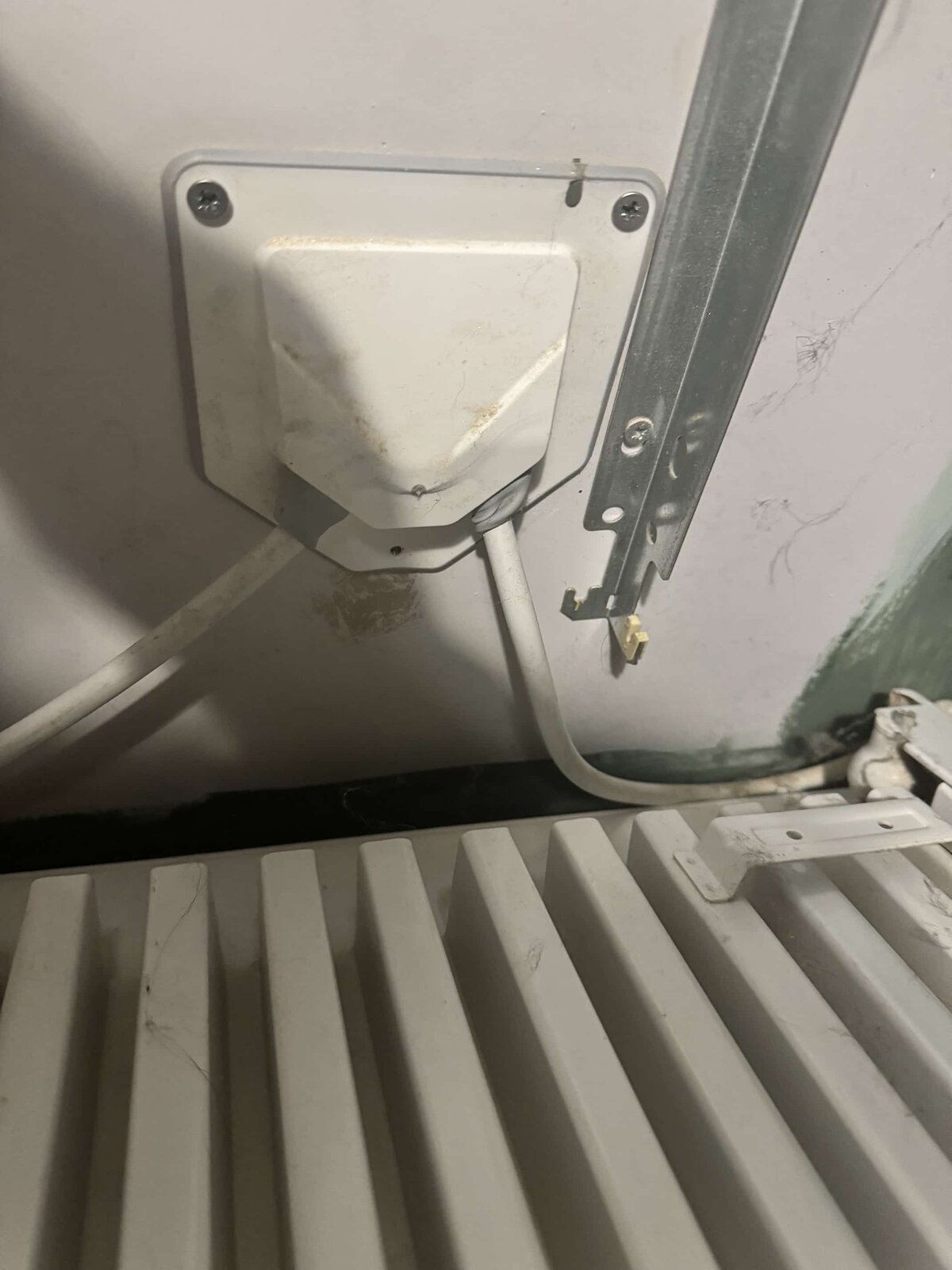

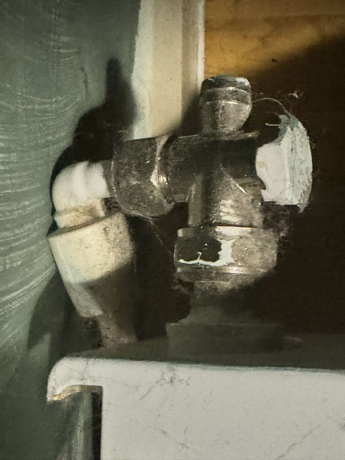

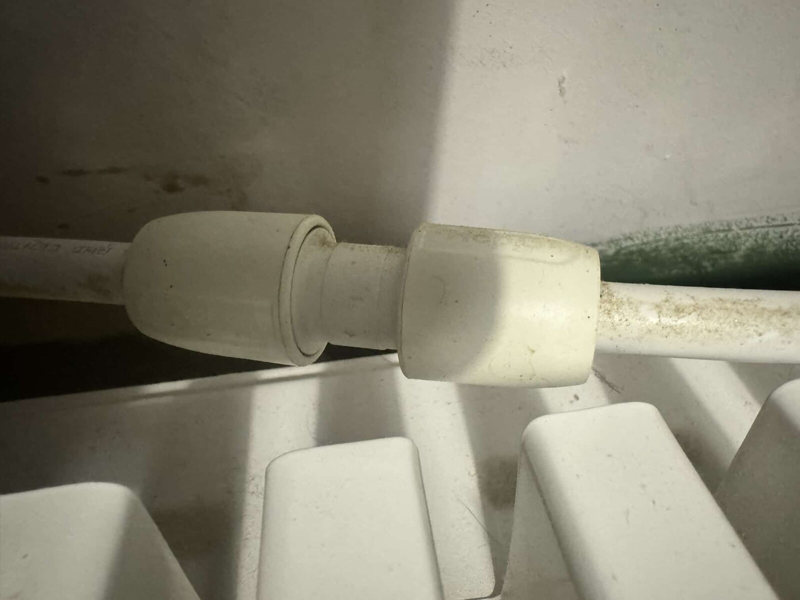

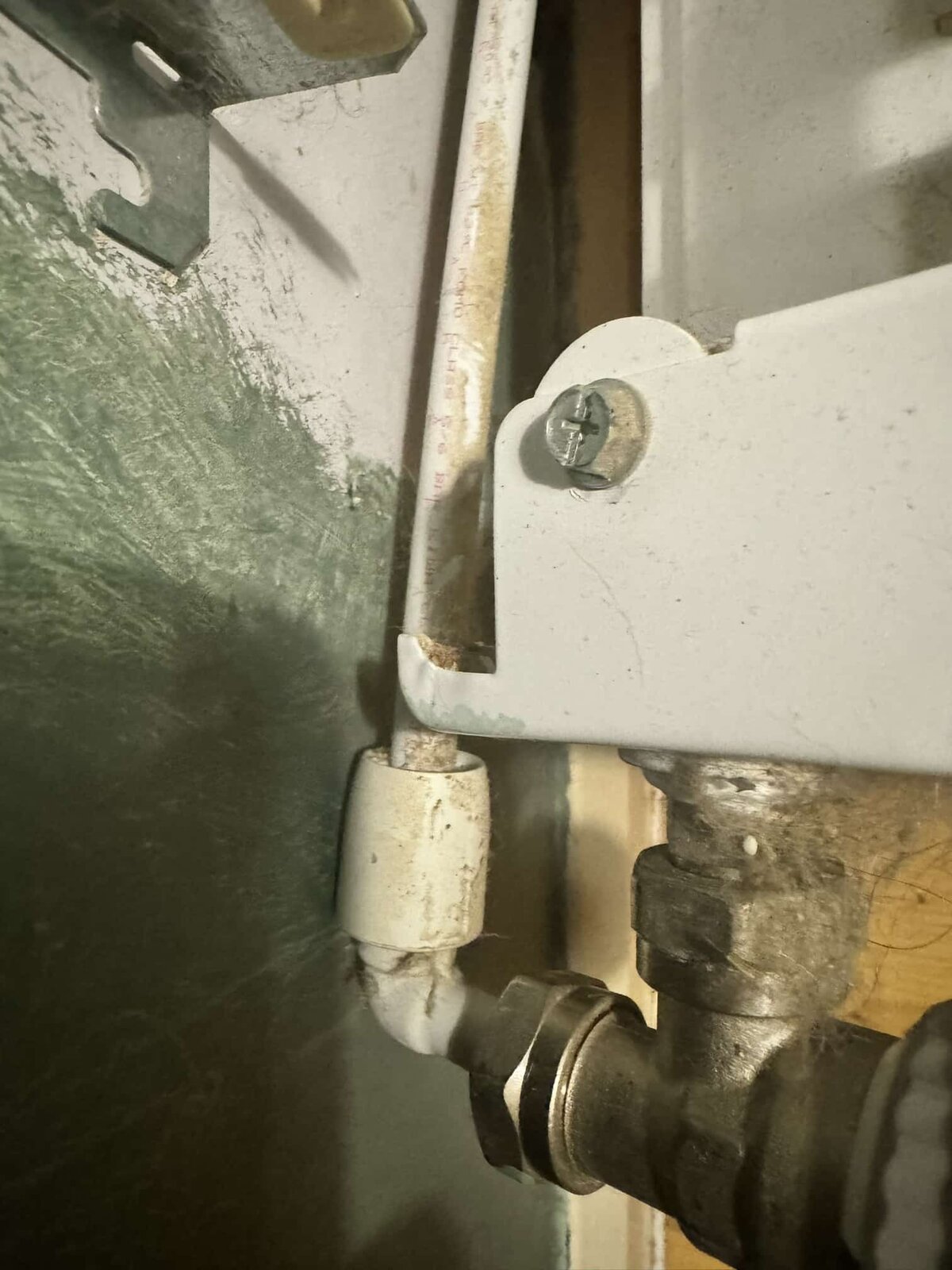

On the same subject of radiator removal I have it looks like 10mm plastic system I want to remove with the least hassle to allow fitting kitchen cabinets. I have attached photos below just to confirm what I’m looking at. Any advice would be greatly appreciated thanks.
