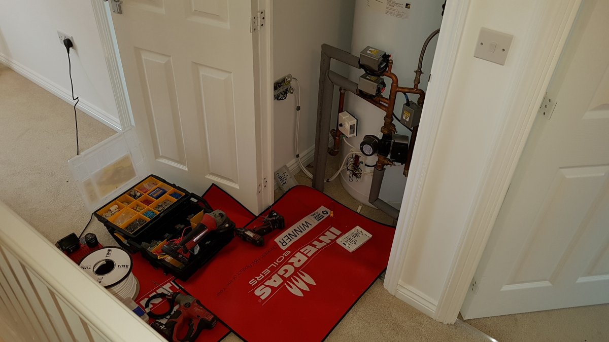

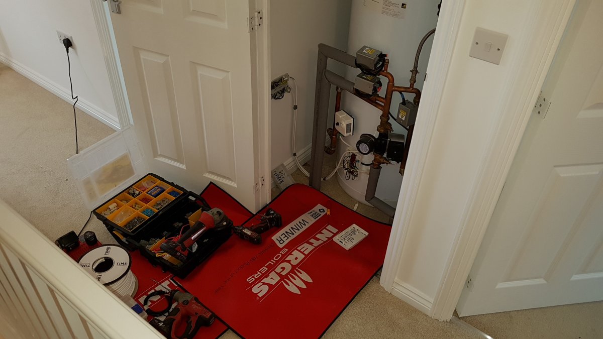

Evohome or sundial pack. Doing an Evohome at the moment. There is much snipping of wires:
Thanks Evo-home looks like the way forward then
