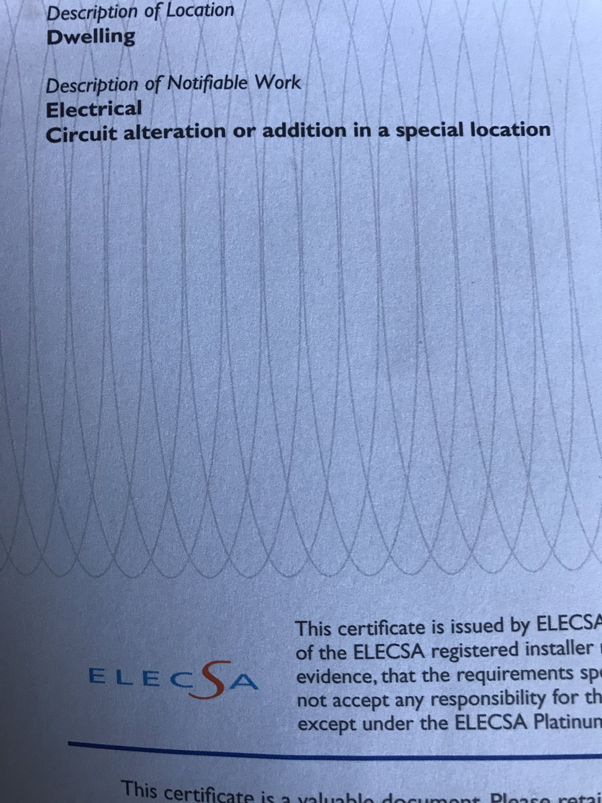

Compliance Certificate.
Thanks for clearing that up so the next question is how do I get an EIC now it's been 12 months since completion?
From the electrician who did the work.
If you have only just received the other document, the electrician has only just notified it - the certificates are sent from the schemes within a few days of the notification.
Therefore it's reasonably likely the electrician has only just completed the other document as well.
