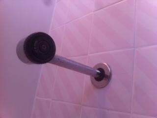

Customer wants me to change just the head on one..
the shower spout goes into the wall do you no if it would be a back plate elbow threaded connection... or compression??
if its a threaded connection is it as easy as unscrew out and screw new back in??
also if I can get away with it can you just buy a new shower head rather then change the bar/spout???

The tube should have a 1/2 male thread on the end and screwed into a 1/2 female socket inside the wall, there should not be any compression fittings in the wall so should be a soldered elbow, but you never know.
