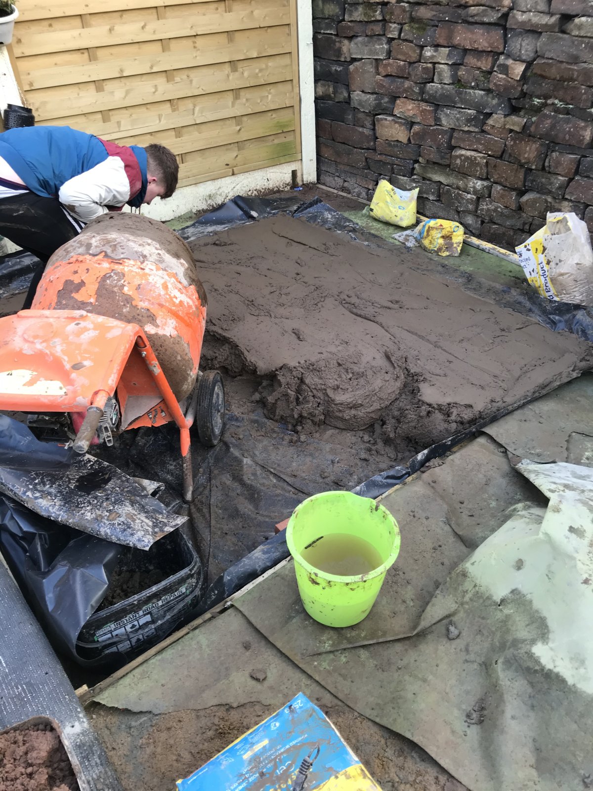

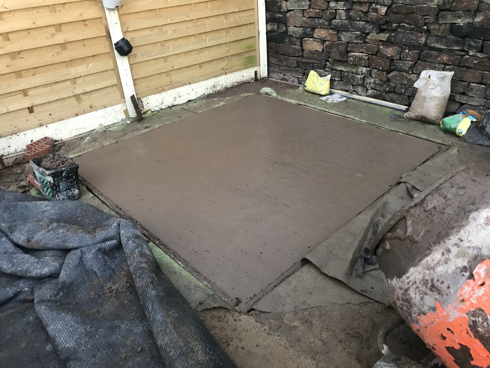

I just did one 2.4 x 2.4, 125-150mm thick with a mixer. 2 bulk bags worth of ballast, 6:1 mix, no problems with it starting to set and I levelled it with timber dragged over a timber frame.

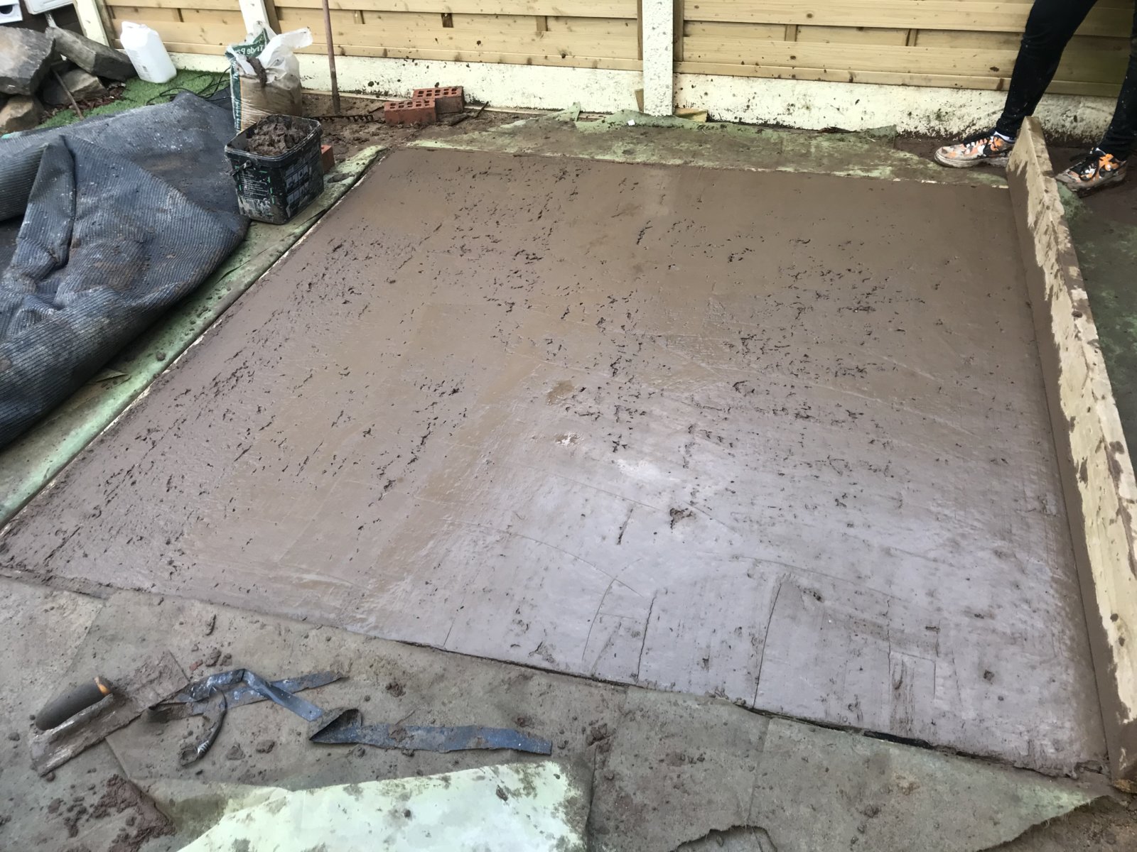

Great cheers. Did you find that the concrete was perfectly level with no rough spots?
Did you have to trowel any parts to get smooth?
How long did you leave timber shuttering in before removing it?
Perfectly level but a few slight indents where the wood caught stone.
I trowelled all I could reach once I finished levelling it.
The timber is still in there, it took over 24 hours to cure, to be honest I was ****ting it because I thought the frost killed it but it’s rock solid today.
Looks a good job you've done there.
Are you keeping the timber in?

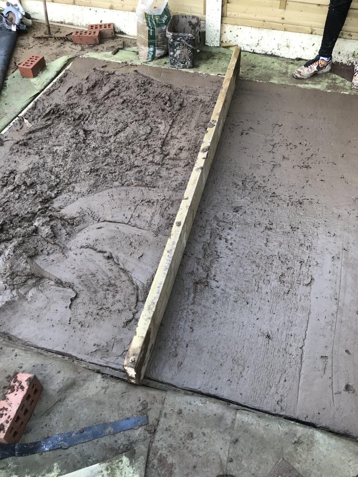

When you levelled the concrete by using the timber, did you just run it over or did you use a sawing action with the timber while sliding along?
Yes, going to leave the timber in it will be under fake grass.
I first tamped it in an up/down motion then sawed it across twice, first time was hard because I had too much stuff in. I scraped the excess off with a trowel. Second time was easy and got it really flat.
That was on Sunday and I walked on it for the first time today.
