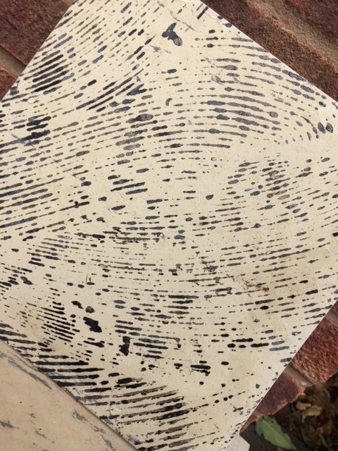

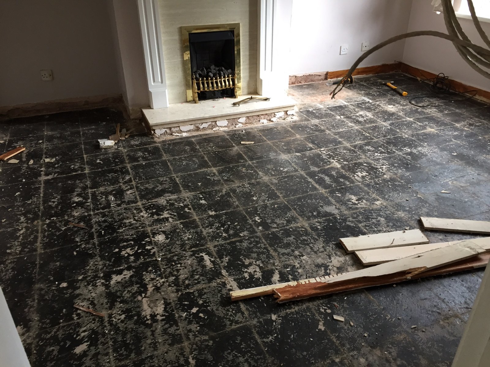

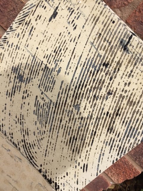

There is no membrane beneath your floor or any others of this period. The damp course will exist in the walls only. The marley tiles and bitumen acted as a dpm of sorts.
Pity you took the screed off as, like me, you have an inch to build back up. Look at my posts and you may see images of mine.
Sorry - only just saw this, yeah I totally understand you last statement.
Did you manage to build back up the screed to around an inch? IF so, what did you use? I need about 30-40mm (differing in places) which is annoyingly too shallow for screed as it may crack.

I had damp around the wall base, and around the edges of the carpet. However I'm not entirely convinced it was rising damp, I'm not getting anything damp coming through now, so it was more than likely condensation forming on the coldest part of the room, the corner of the cold concrete floor/and base of the walls.
