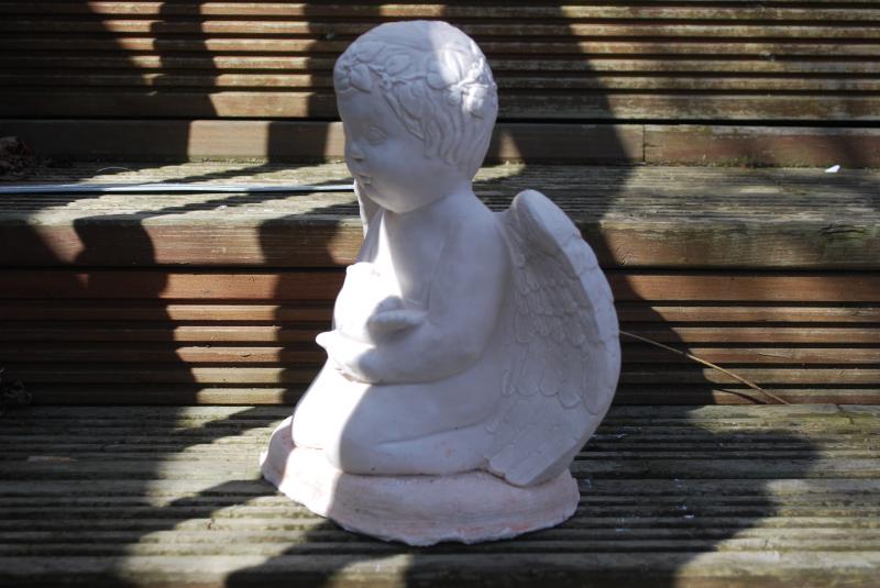

I once made this mould.
It took me ages and it made this water feature.

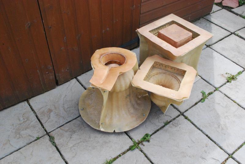

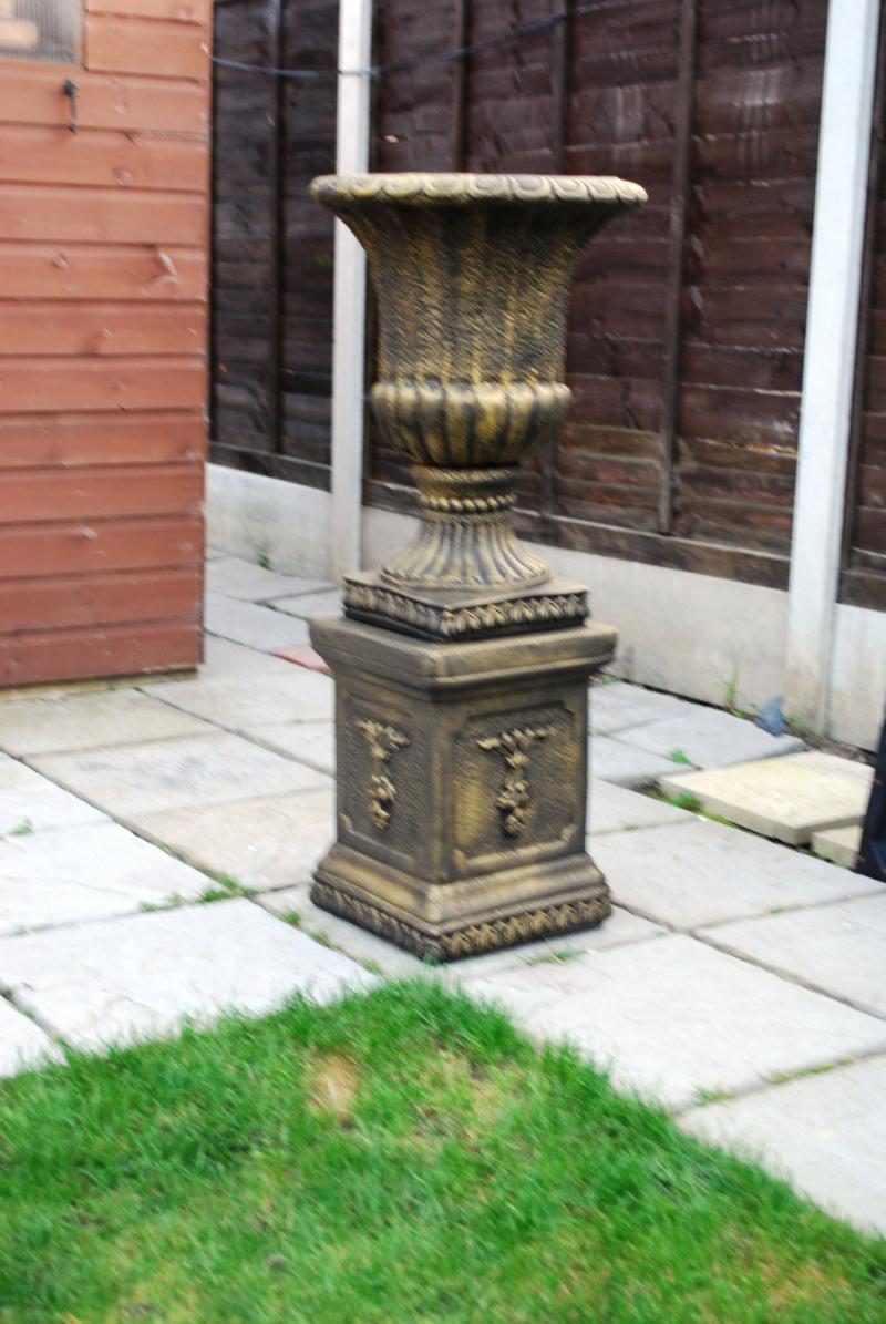

I have made quite a few moulds planters urns plinths etc.

Once you master the art of fibreglassing you will be making quality moulds like this planter mould I also made.

Yes but you have to think about how it will come apart. Same with the latex on things like the urn part of the planter.
Yep, in these cases you need to make a parting line (splitting joint) down the length of the mould. This can be in one flat plane or stepped if the pattern dictates...pinenot :)

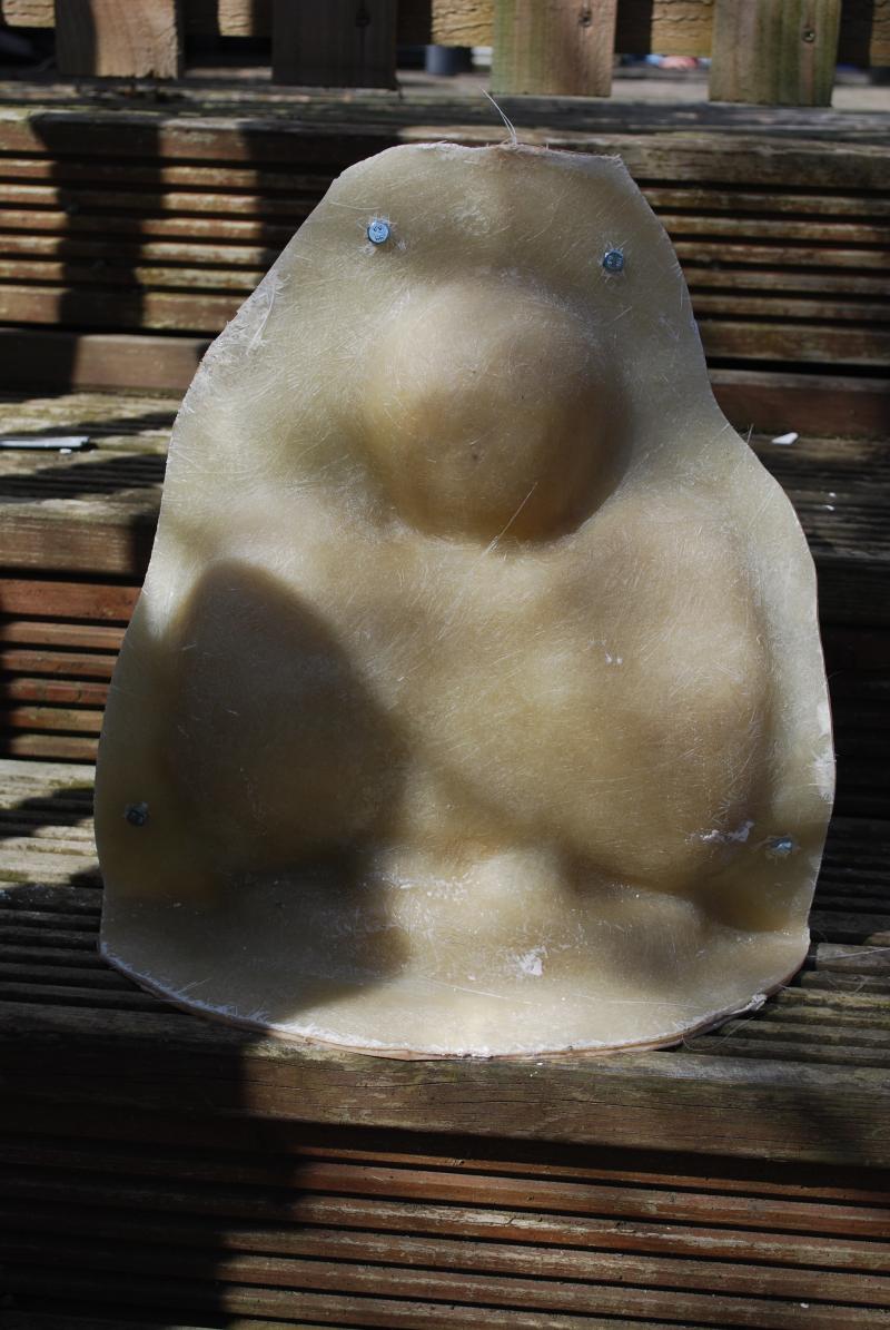

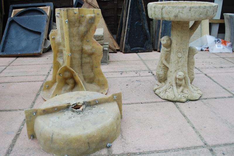

My brother made this birdbath mould and I was telling him it would never work but I was shocked that it did work when he finished it.
To the op start with something like this little mould so if you go wrong you wont have a lot of money in it.
