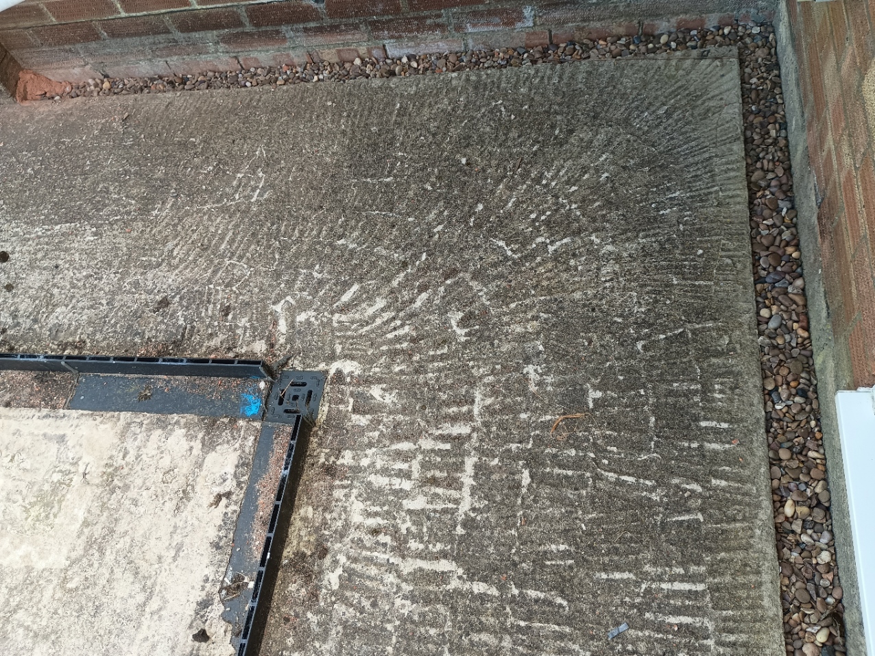

Recycled rubble concrete after 5 years of weather...
The clean bits are from dragging scaffold around on it recently. A bit soft on the surface but definitely not falling apart.
