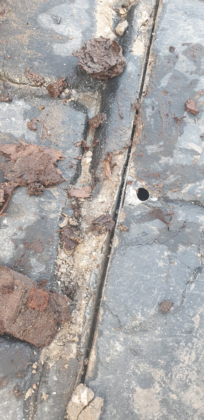

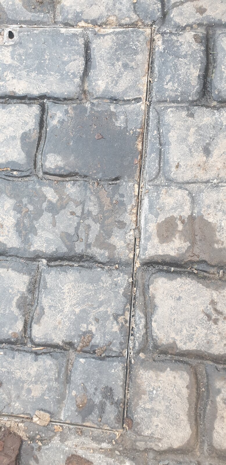

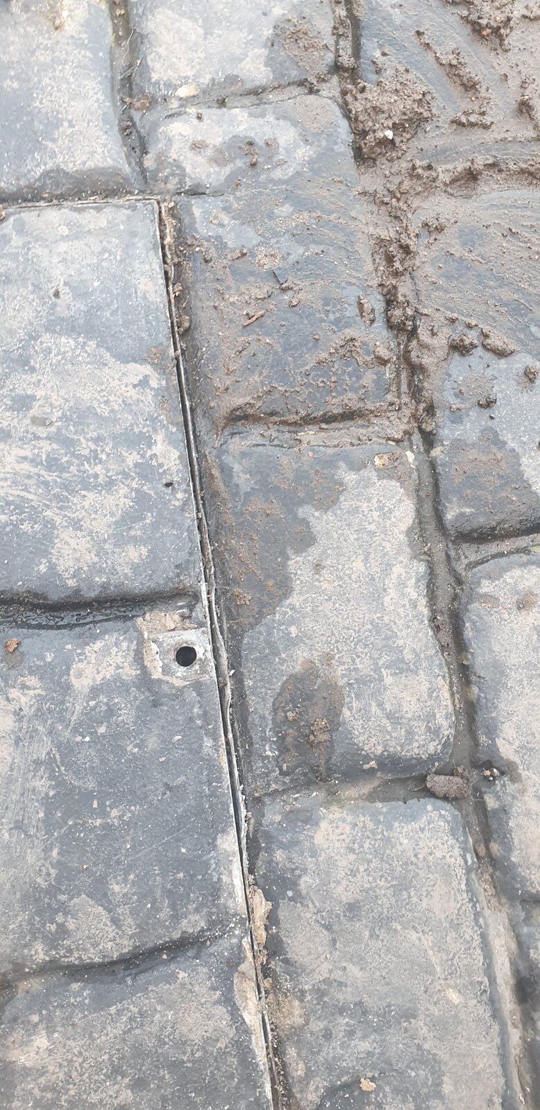

VICTORY!!!.. like u said turbo, had to seperate the frame from the cover all the way round by hammering a big flat head screwdriver between them all the way round. After that, I had to use two big flat heads and a lifting hook off a crow bar and fulcrum all at the same time to get it off. Cant believe how the two metal plates had pretty much folded together all the way around.

I've put the lid back on now. I'll takema pic of the damage ive done getting it off. I'm not bothered about the damage tho, the drive is getting done soon enough.
