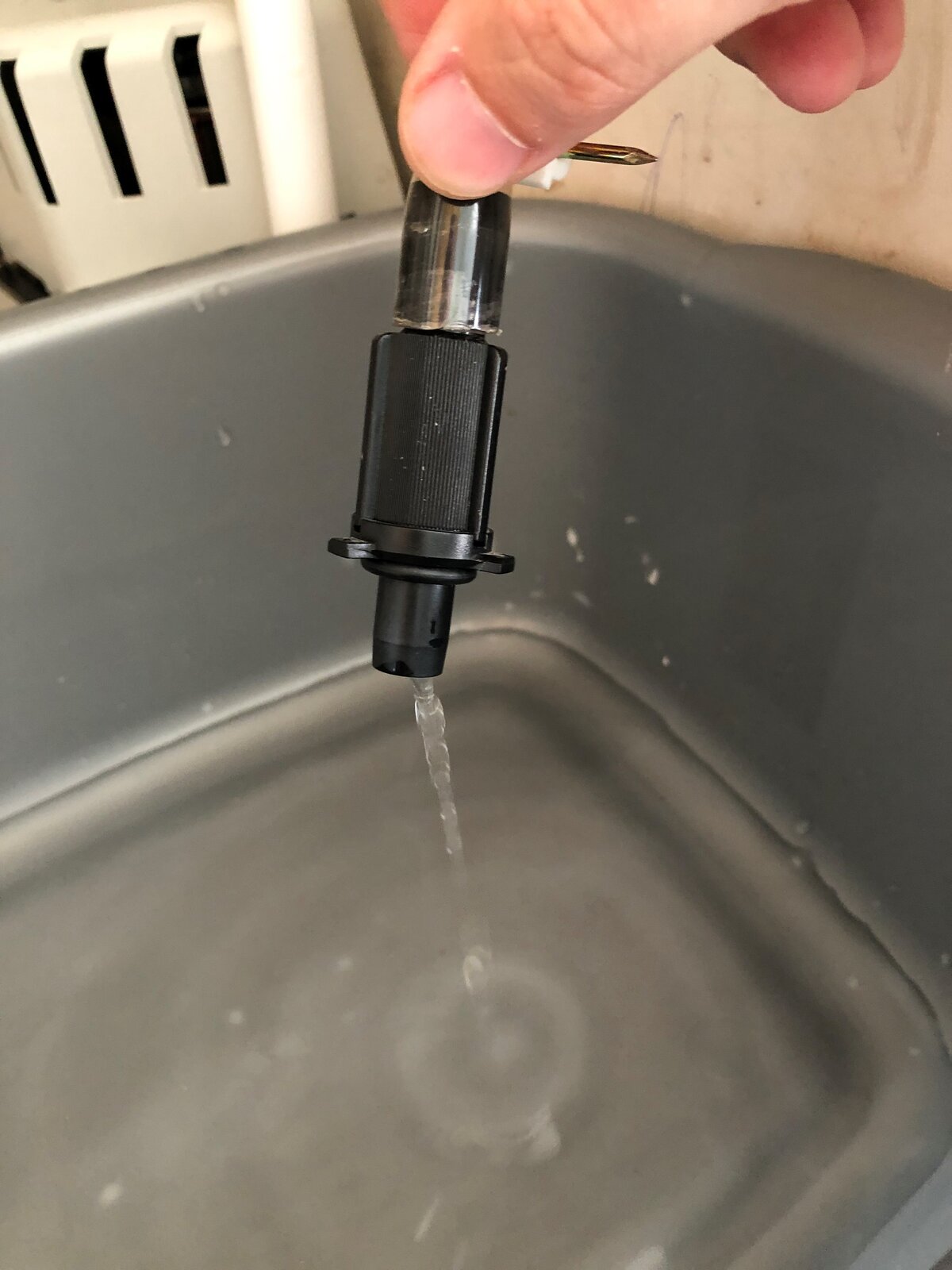

@ianmcd A huge thanks to you, got your guidance on this. With your help I've isolated the problem down, and through elimination have proved it to be a problem with the NRV. So I have one on order, this morning as the pot and exit pipe was full of water, I removed the NRV with the exit pipe attached, and it all but poured back outwards through the NRV into the bucket.

New Non Return Valve (NRV) turned up yesterday, in a pack of 3. Fitted the new part and its a little smaller where the pipe attaches, but it does the job.
I added a little PTFE tape, and secured the pipe in place. And all seems well. Many thanks Ian.
To summarise the issue I had, in the hope that if someone searches for this again it may help.
My boiler / heating / hotwater all seemed to be working fine, but the boiler feeds into a condensate pump and is pumped up into the attic and to the soil pipe.
The pump would activate every 10-15 minutes, and then into the evening it could be every 3-5 minutes.
The piping was checked for any blockages (get a bucket to catch the water from the tube.
And it seems likely that the Non return valve (which should stop the water from draining back into the pump) was leaking water back in to the sump of the pump. Anfd then activating the pump again, on repeat.....
To test this you can remove the exit pipe (remember to drain it) and replace the tubing with some other tubing (hosepipe works with a little clamp) and you can drop the water to drain into a bucket below. - This drains the water away so it cant drain back in.
Alternatively, what you can do, is to remove the NRV with a simple twist, whilst the exit pipe is still attached. When i did this, it was clear that the water was simply draining back through the NRV.
