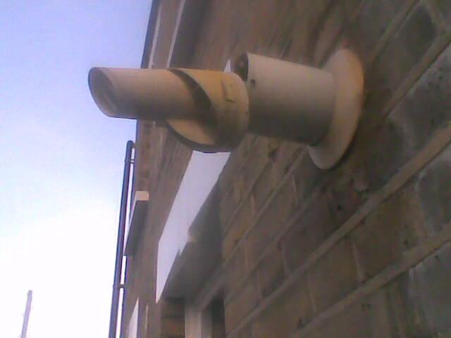

Here is a picture of a Vaillant flue which discharges directly over a pavement in Leytonstone ( non essential info Billy? ). Since the picture was taken the terminal end has fallen off!
Yes, and not before time. Don't you think it coincidental that the boiler of choice for the former governments WarmFront Scheme is the Ideal and that Ideal's factory is in the former ODPM constituency?
