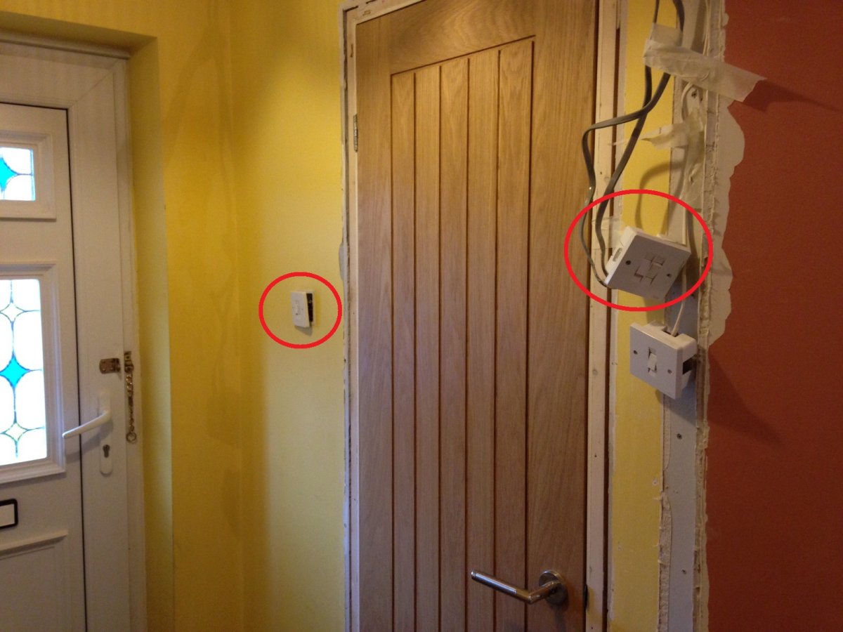

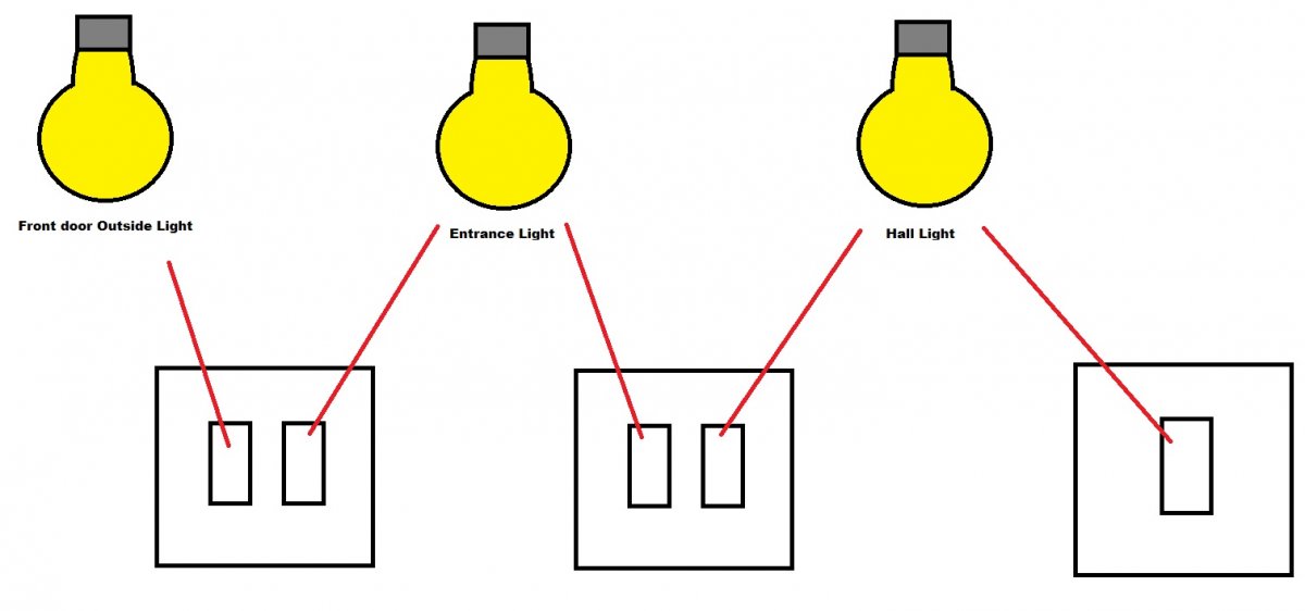

I've just removed a small stud wall/door way between the entrance hall and main hall. Before the re-plastering and decorating starts i'd like to reduce the number of light switches if possible.
Photo/diagram below to give you a better idea of what i am talking about.

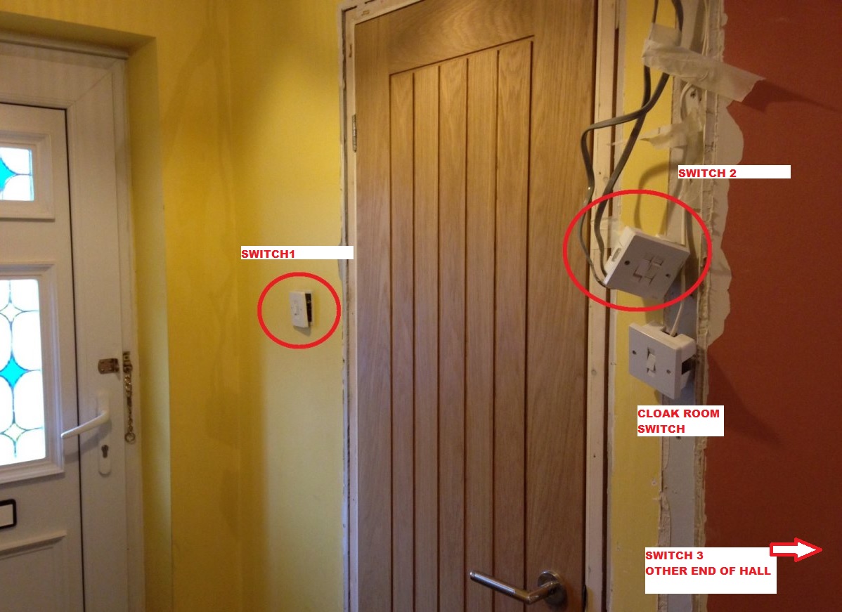

As you can see there's a double 2 gang switch near the front door which operates the outside light and the entrance hall light. There's a second 2 gang switch only a foot or two away (this switch was on the other side of the removed wall). This switch also operates the entrance hall light as well as the main hall light. There's a third single 1 gang switch which operates the cloakroom light. Finally there's a single 2 gang switch (not shown in the photo below) at the far end of the hall which operates the hall light.
I'd like to replace the first switch with a single 1 gang switch to operate just the outside light. I would also like to replace the second and third switch with a double 2 gange switch to operate both hall lights and the cloak room light. I assume this would mean putting the entrance hall light and main hall light on the same circuit/switch (ie: so both lights are controlled by the same switch).

However, from your diagram, it looks like it could be configured as you want.
If you want to do it we would need to know the connections and colours on all of the switches.
I don't understand why both the hall light switches are next to each other.

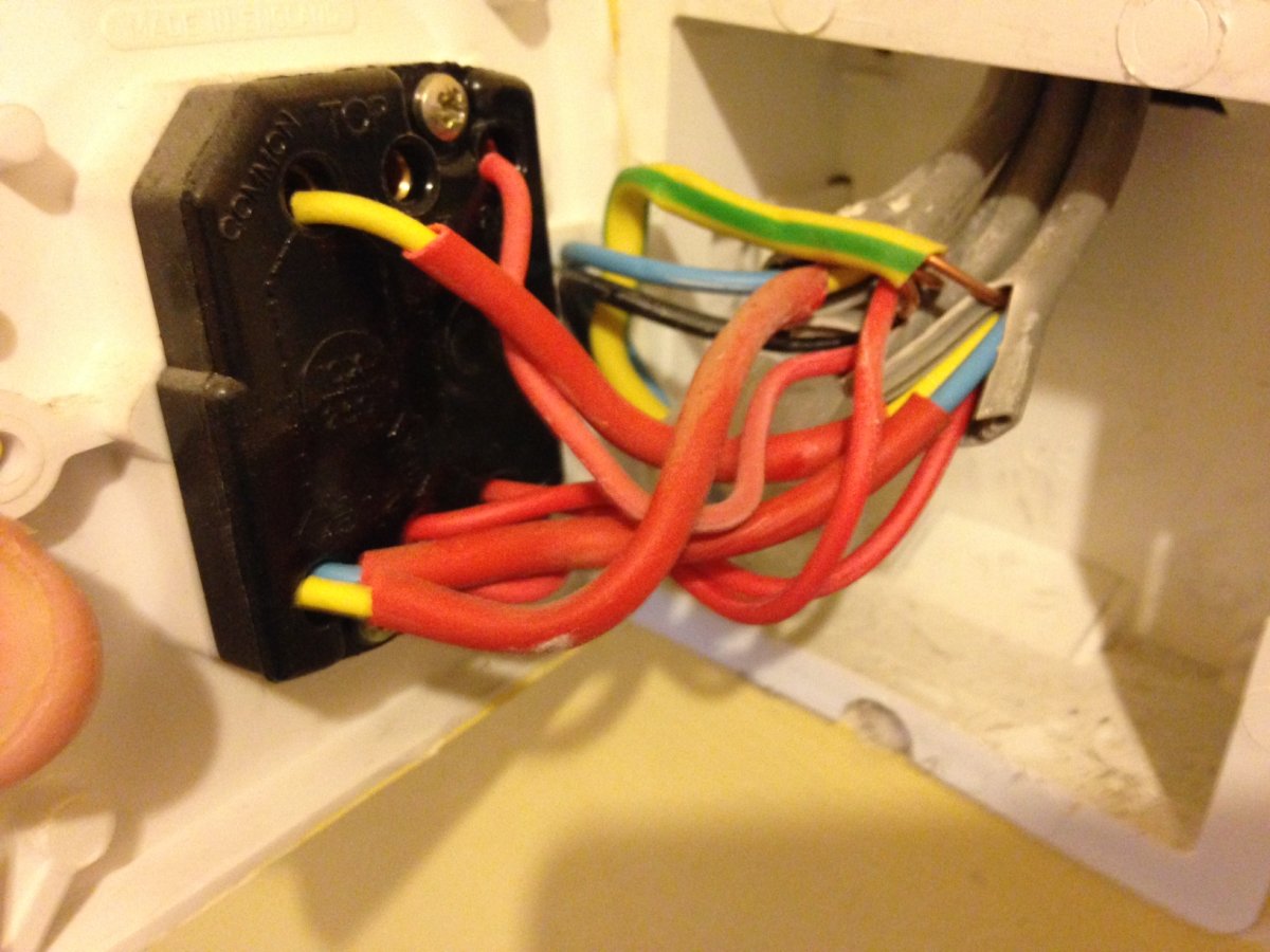

Switch1 (double, 2 gang - operates entrance hall light and outside light)

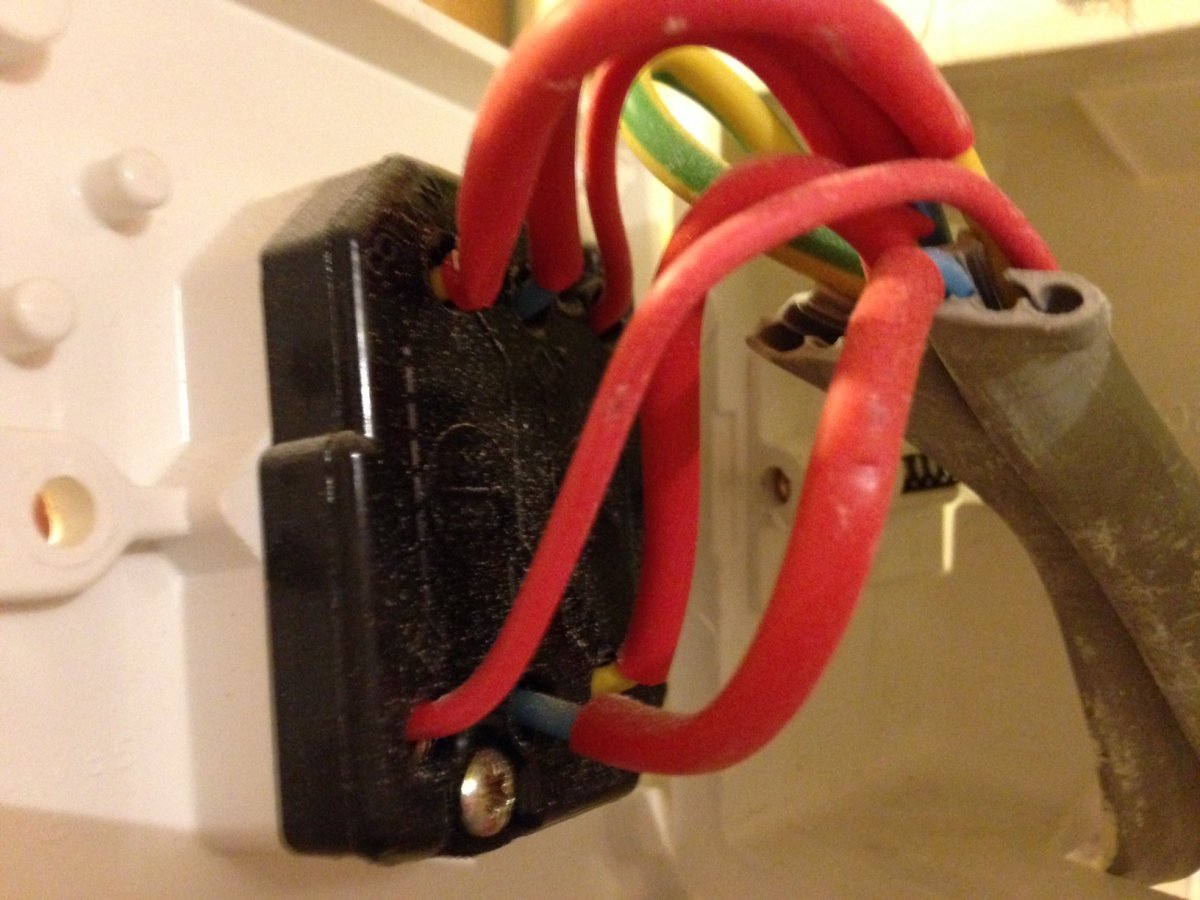

Switch2 (double 2 gang- operates entrance hall light and main hall light)

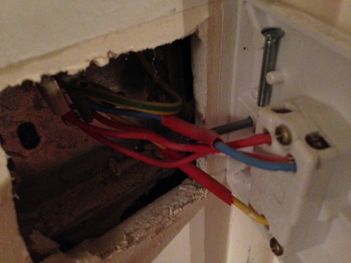

Switch3 (single 2 gang - operates main hall light)
i didnt bother taking a photo of the single cloakroom switch as i assumed this wasnt necessary. let me know if you need connection details.
In switch 1, can you take another pic so I can see more clearly the wires which are behind others in the first pic and
confirm that the black and blue which are near each other in the pic are NOT connected to anything.

Having drawn it all out on paper, it looks like what you want to do is remove the entrance porch light & its associated switches. Or do you want to keep the entrance porch light and connect it so that it comes on together with the hall light?
That will leave a 1 gang 1 way switch by the door for the outside light, and a 2 gang switch for the hall (2 way with the existing untouched switch at the other end of the hall) and toilet.
Are we to assume the hall/ toilet switch is being recessed where the stud wall was (ie not re-siting that switch)?
So, it is a case of identifying, disconnecting and removing the switch wiring (or connecting all cores to ground) then fixing the hall/ toilet switch box and recessing the wiring.
