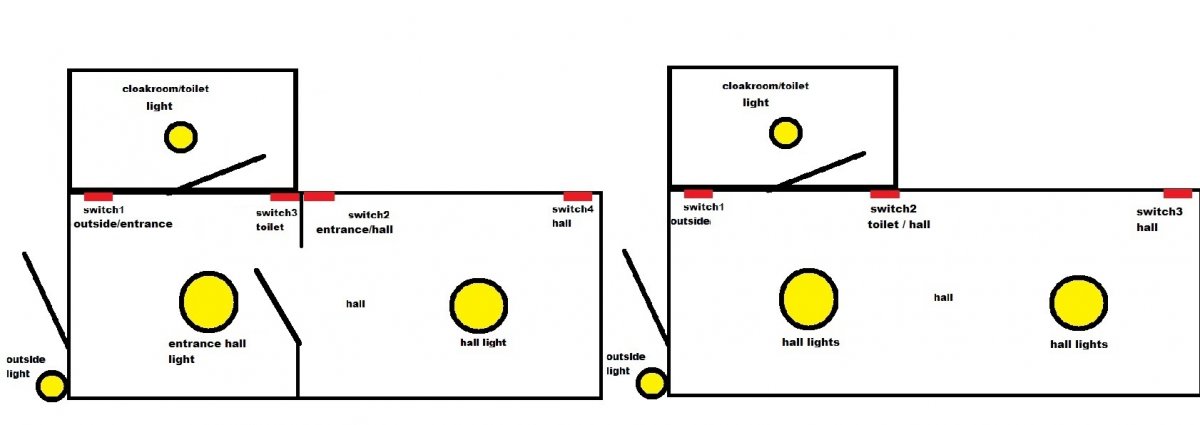

Having drawn it all out on paper, it looks like what you want to do is remove the entrance porch light & its associated switches. Or do you want to keep the entrance porch light and connect it so that it comes on together with the hall light?
That will leave a 1 gang 1 way switch by the door for the outside light, and a 2 gang switch for the hall (2 way with the existing untouched switch at the other end of the hall) and toilet.
Are we to assume the hall/ toilet switch is being recessed where the stud wall was (ie not re-siting that switch)?
So, it is a case of identifying, disconnecting and removing the switch wiring (or connecting all cores to ground) then fixing the hall/ toilet switch box and recessing the wiring.
I think Securespark has understood what i have poorly portrayed.
The left most double switch controls an outside light and entrance hall light. The next double switch (was originally located on the other side of the stud wall) controls the entrance hall light and the hall light. The single switch, shown in the photo, operates the cloakroom/toilet light. Finally there's another switch (not shown in the photo) at the bottom of the hall which operates the hall light.
Blue Peter style diagram of how it is (on left) and how i'd like it (on right)

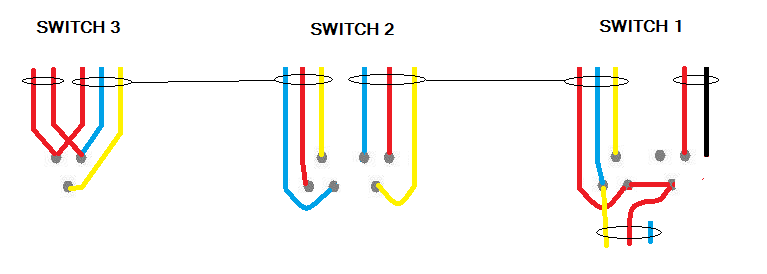

So far I have:
RYB three core connected to entrance hall switch.
RYB three core which I think comes from the entrance hall light carrying red (feed to common of outside switch), yellow (switch wire?) and blue (neutral for outside light).
RB twin and earth with black connected to blue and red connected to L1 of outside light, but there is a wire missing on my diagram that I cannot see clearly in the picture. There must be a feed to the terminal with the red wire in on the entrance hall switch linking to the common on the outside light switch.
The yellow of the 3 core in switch position 1 that has the blue connected to the black will be redundant in the new set up, but you need to keep the other cores to give you a feed and a neutral for the outside light.
The other 3 core in switch 1 can be disconnected and removed. This will link to switch position 2, being the other side of the 2 way switching for the entrance hall light.
The (now spare) way in switch 2 can be used for the toilet light.
At the entrance hall light ceiling position you will need to disconnect the yellow that is in the 3 core that drops down to the switch 1 position.
The entrance hall fitting will need to pick up a switched feed from the other hall light.
Your diagram looks accurate to me and very clear/easy to understand.

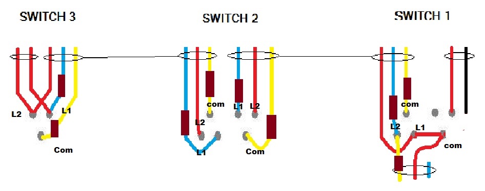

Looks like you've both figured it out anyhow, but should it help i've marked the cables which are sheathed/sleeved.
Again, thank you both for the help so far ;)
The blue & black in switch 1 are connected with a terminal block
Yes, the blue and black should be connected.
Great! - so now you know exactly what goes where with no guesswork.

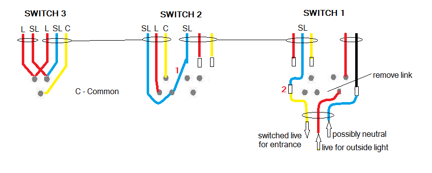

Here you go.
To keep Bas happy, Study it so you understand how it works.
Only two alterations - 1 and 2
Disconnect the other wires and terminate in a connector block.
You can put the red and yellow in one block if you want.
If you are going to remove the switches to feed in the cables, number all the wires before disconnecting.
