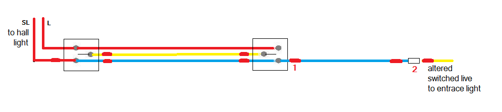

Here it is in linear form which is easier to understand:
Just one more alteration:
3. Remove the live link between switches in Switch 1.
It's on EFLI's diagram but not numbered.
That doesnt look too difficult to do.

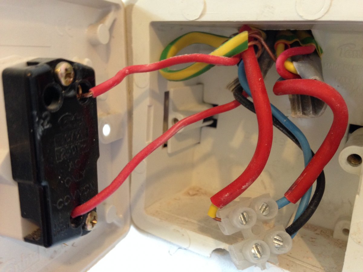

Ok so now i have...
Switch 1 - single switch which controls outside light
Switch 2 - double switch which controls toilet light and both hall lights
Switch 3 - single switch which controls both hall lights
Switch 2 turns on & off both the hall lights.
Switch 3 turns on & off both the hall lights.
However, if i turn the hall lights using one switch and then try turn them off using the other switch, what was the entrance hall light, stays on. Any ideas where i went wrong?
Switch1
Switch2
I tried disconnecting the neutrals (blue & black) on switch 1 but this prevented the outside light from working.

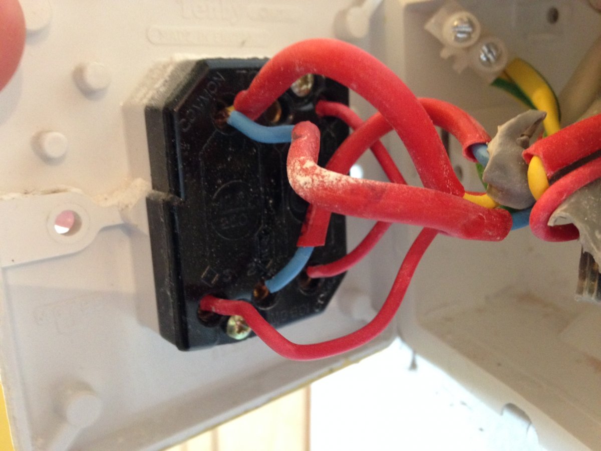

In Switch 2:
You need the blue that is currently in the common terminal with the yellow moving to the terminal with the other blue.
I thought you said it was staying on permanently before you moved the wire?
EDIT. If you remove that blue wire and just make it safe with a terminal block on it, when you restore power is the entrance hall light on or off?
No not quite, sorry my fault for not explaining fully.
Before moving the wire i could turn on and off both the hall lights using switch 2. I could also do the same using switch 3. However, if i turn the lights on with switch 2 and then try turning them off with switch 3, only the main hall light goes off.
If I disconnect the blue wire the entrance hall light goes off and no longer works from any switch.
If the Live and SL are in actual fact the other way round to that in EFLI's diagram, then instead of being in the terminal with the other blue, it should go with the red in the bottom LH terminal.
Spot on! It's now working perfectly.
