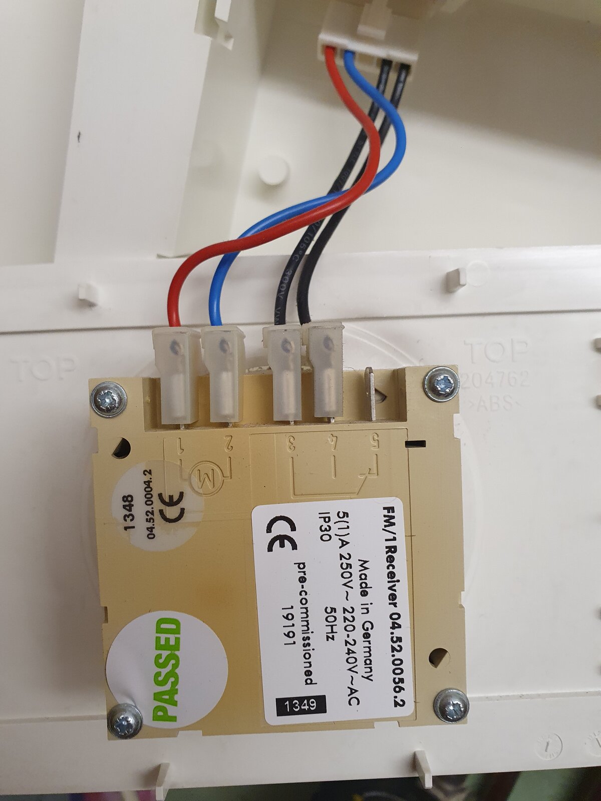

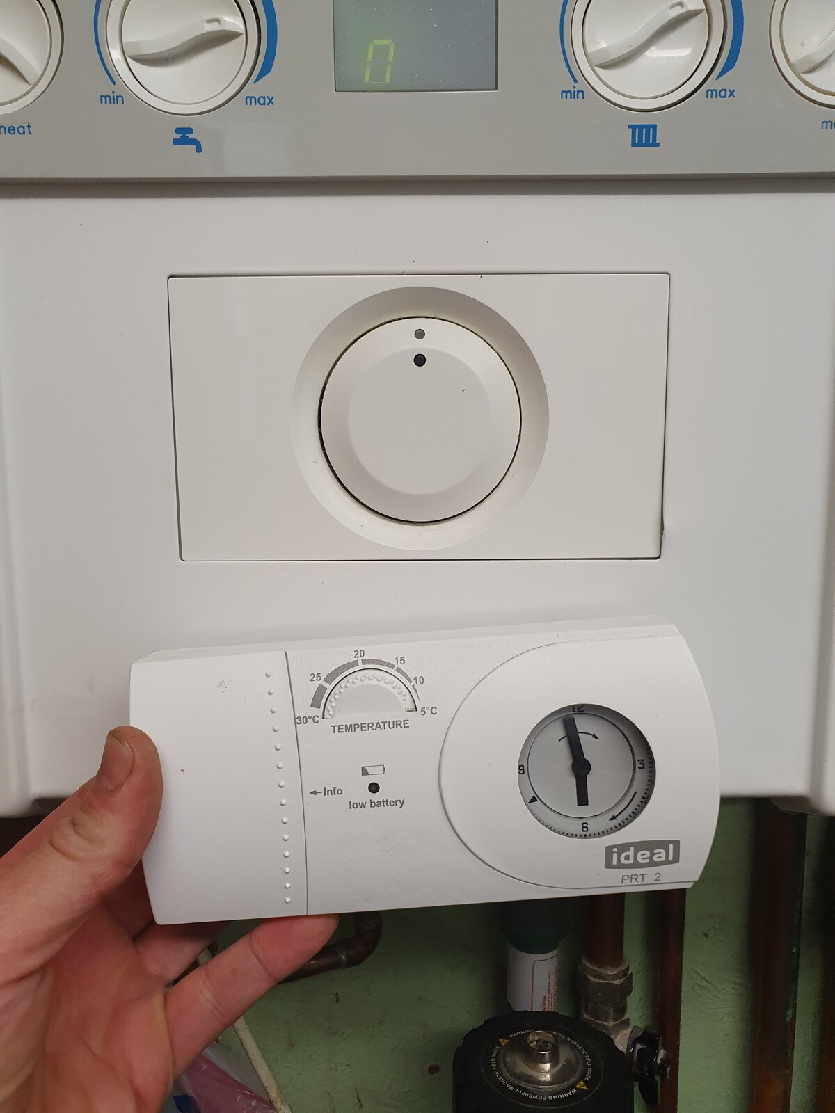

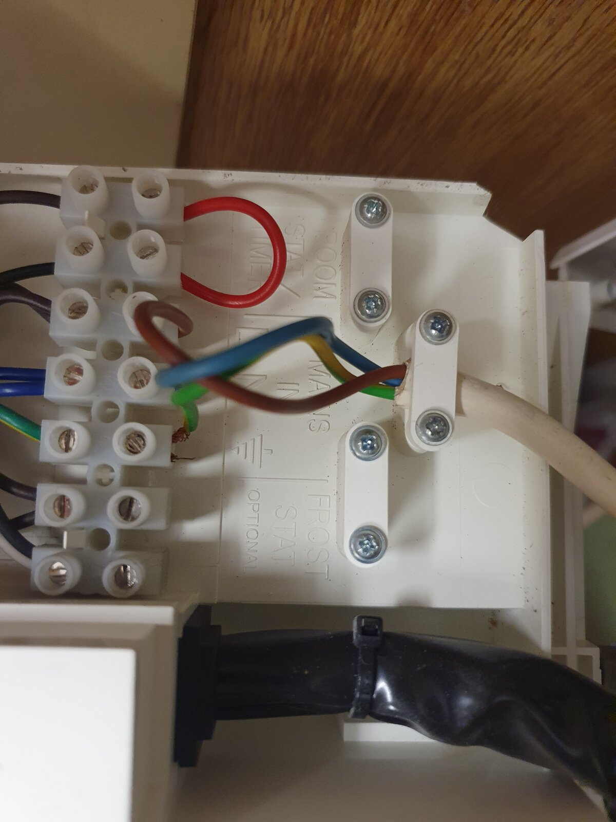

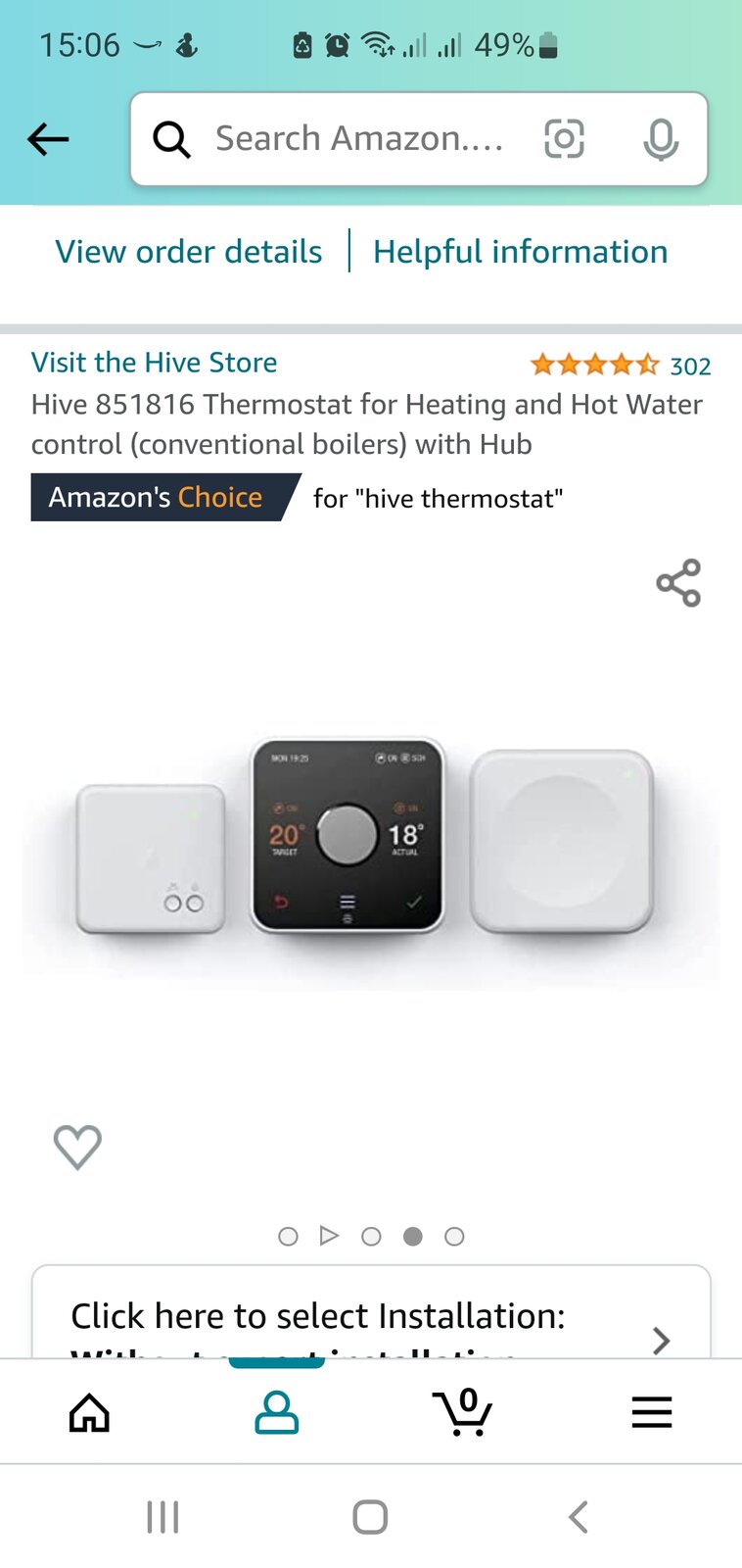

Hi guys I just bought a Hive thermostat and I want to replace it with the old one. Please can somebody help me with that? Please see the pictures below. Thank you very much.

The hive is just a internet connected on/off control, it doesn't actually do any load compensation or weather compensation.
If that pic is the actual Hive you have bought it is the wrong one, that is a dual channel hive for stored HW systems you have a combi and need the single channel hive, and you need to sort that earth wire on the boiler
