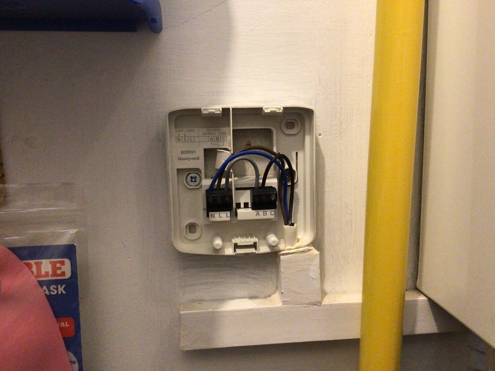

Hi, I have bought a hive system for combi boiler and wish to replace my existing Honeywell thermostat. Please see photo of existing wiring. Can anyone tell me which one goes where on hive unit please?
From Honeywell to Hive:
L - L
N - N
B - 3 (Normally Open/Heating on)
Remove L - A and transfer to L to 1 (Common) on Hive
Job done.
Thanks for the info Chris.
All done jobs a good one.
