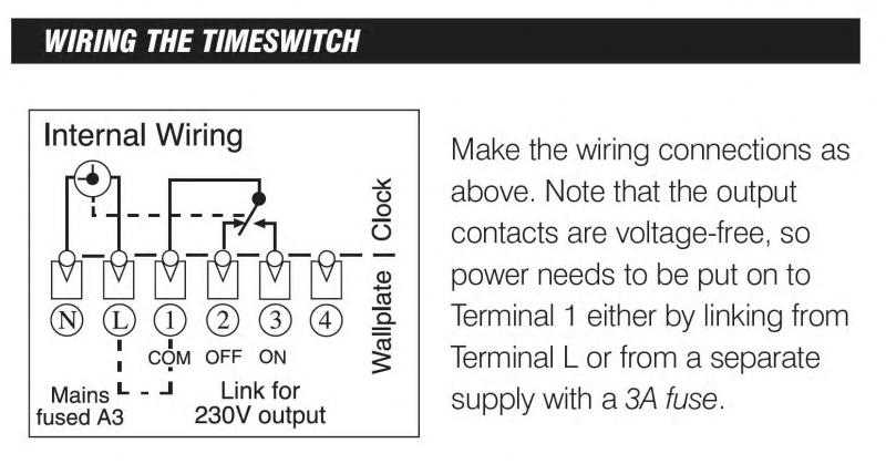

Confused by Drayton Lifestyle LP111 wiring

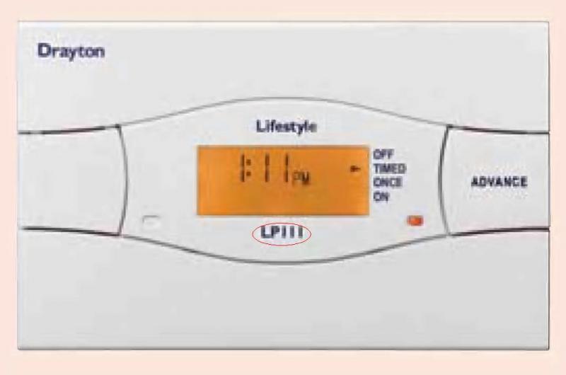

It says LP111.
Everyone is telling me it cannot be wired the way it is.

The pins I quoted were looking at the faceplate on the wall, not looking at the controller itself. Dont be confused by that or by trying to look at instructions if you don't fit them yourself, thats just confusing things!
I was working left to right. There are 6 terminals the first is neutral the last is a brown wire, i.e.live and it heads off towards the boiler.
Am I correct in saying that what I am trying to do is take the live wire that would head off to the boiler and send it through the thermostat? So when the thermostat is on, it connects that live instead of the LP111?
It says LP111
Here is the "official" wiring diagram.
Basically, Yes; but your thermostat also needs a neutral connection.

The way the last wire entered the unit made it look like it went into position 6.....when it actually....went into position 5....just like everyone told me.
Ouch!
LOL
That matter aside, I fitted the unit today and it is working perfectly, now at least I have some kind of rudimentary control over this thing till I can afford to get it all upgraded/replaced later in the year.
Thanks to all and apologies for me being an idiot.
