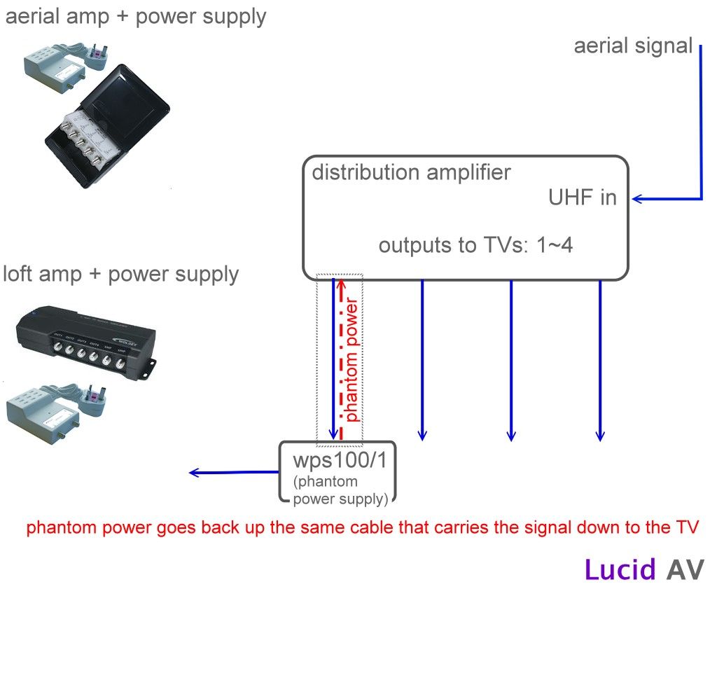

I have a TV distribution system. (Wolsey WPS100/1)
The coax from the aerial comes to the box next to the main TV (which is connected to the power supply). The cable goes to the pvr 'ant in' then the out goes to the tv.
My pvr is also connected to the tv by hdmi cable.
Can I connect the pvr to the other TV's? so that all TV's can then watch what has been recorded.
I did this years ago with my vcr before digital tv.
Not without replacing the existing aerial/distribution amp or some significant rewiring.
A WPS100/1 is a power supply for an aerial- or distribution-amp. It isn't a distribution-amp in it's own right. This uses something called phantom power to get power to either a loft box or mast mounted aerial amp. Phantom power is where a cable that carries signal in one direction (e.g. amp to your TV) carries power in the opposite direction.
In order for your aerial signal distribution system to work the way you want with the gear you own, you'd have to have the aerial feed from the roof come down the outside of the house and in to the living room, then go in and out of the PVR, back up to the loft/roof, into the UHF input, and then be distributed by the amp.
If the signal is strong in your area and you simply have a loft box then this may be possible. But if your install uses an amp attached to the aerial mast then things become trickier. It may be that the aerial signal is a bit marginal so the amp is boosting it before distribution. If that's the case then there's a strong chance that it won't survive the journey to and from the living room before getting back to the amp.

The only point I would add to Chris' comments is that, if your masthead was installed before analogue switchoff, it may not be needed now*. But the only way to find out is to remove it and connect the cable directly to the aerial. At some point you'll probably need to replace the outdoor cable anyway - it doesn't last forever.
*In fact it may never have been needed. Some installers have been known to install inferior cable or NOT replace existing old cable and then charge big bucks to fit an amplifier to compensate for signal losses that shouldn't be happening!
