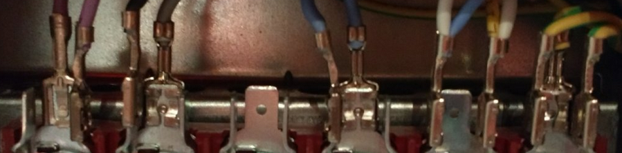

Or spade terminals. Except for the earth.
Well spotted BAS! Spare spade on both Lives and unused spades on the all Neutrals! Only the earth would need a ring terminal!
Changing the subject slightly, the new oven my daughter-in-law bought specified 1.5mm² "heat resistant" flex to connect it. The connection on the cooker was similar to that on the OP's but all you could see was the two (L & N) screws in a heavy plastic block, with the earth adjacent. I went to my auto-electrics box and found three blue ring terminals, which I crimped on with a ratchet crimper. I wonder how many people would have attempted to just wrap the 1.5mm² around the screw, making a bad and potentially dangerous connection? It's not unusual for these ovens to be connected to a 32A cooker circuit!
It is agreed that spades, like ring terminals, have to be crimped, preferably with a ratchet crimper. My point was that the oven, wired in 1.5mm² flex, was connected to a circuit with a 32A OCD, which is twice the continuous rating of the flex.
I was thinking of the open barrel uninsulated ones which the oven has in the picture.
I know. My point is that that would be satisfactory.
Spade terminals still need to be properly fitted - another crimper.
They do. However, maybe I'm over-cautious or over-sceptical, but I think that I would personally be happier with something more 'positive' than a 'pushed on' spade connector (albeit there are already some there!) for the relatively high currents involved, given that the tightness of the contact is entirely dependent upon a bit of bent (and not even particularly 'springy') metal.
Kind Regards, John
I did wonder the same when spade terminals were first mentioned but don't know if scepticism is justified.
I presume they must be rated the same as whatever cable they accept.
I did wonder the same when spade terminals were first mentioned but don't know if scepticism is justified. I presume they must be rated the same as whatever cable they accept.
I don't doubt they are. However, as I said, my concerns would relate to how tightly the two sides of the 'joint' will be held in contact - both initially and over a long period of time - and I can't say that I have as much faith in a 'bent piece of metal' (in a temperature-cycling environment) as I would in a screwed terminal, or even a 'properly sprung' one.
Kind Regards, John
I have often pondered that, the spades are often used in catering equipment, more so for outgoing parts like elements etc and you often see the piggy back ones, but rarely the load on them is more than about 13 amps, I would be hesitant about using them as a supply to an oven, i have often seen the insulated spades discoloured presumably from over heated connections.
