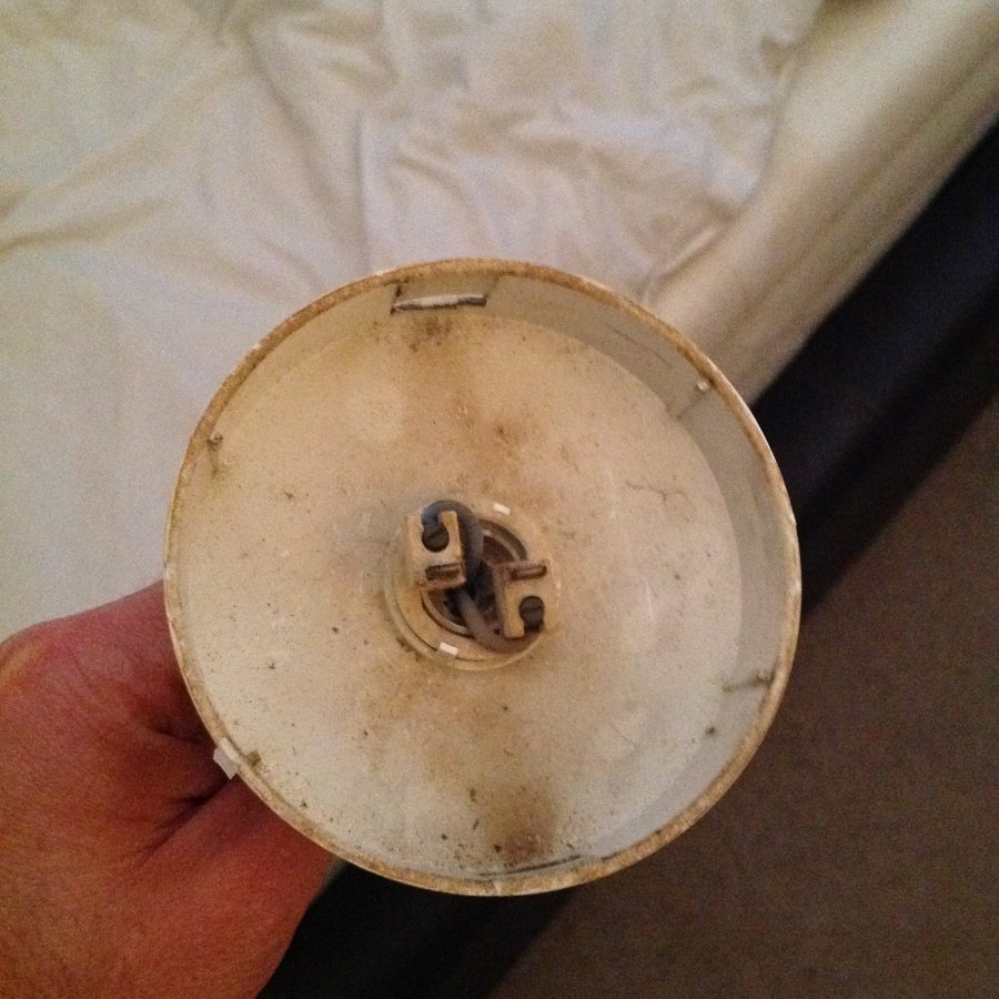

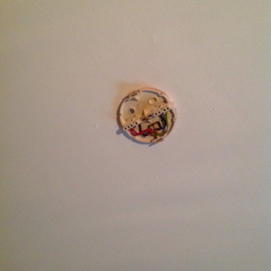

Hi
I'm trying to connect a ceiling rose to this light fitting, please see pics. Which way round should it go please?
Connect to the two blacks.
Ideally you should determine which is the neutral and connect to the blue or switched live and connect to the brown.
