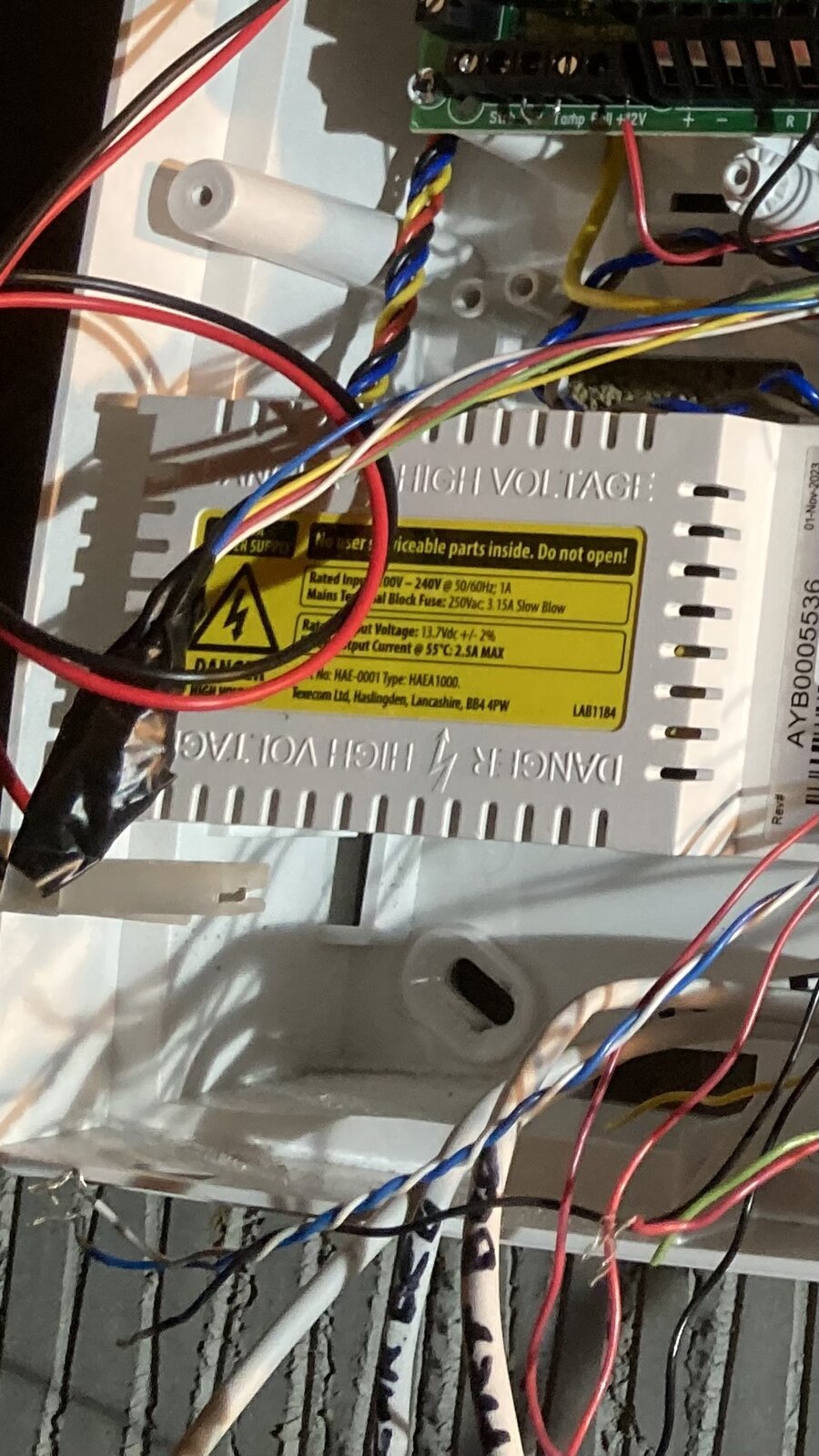

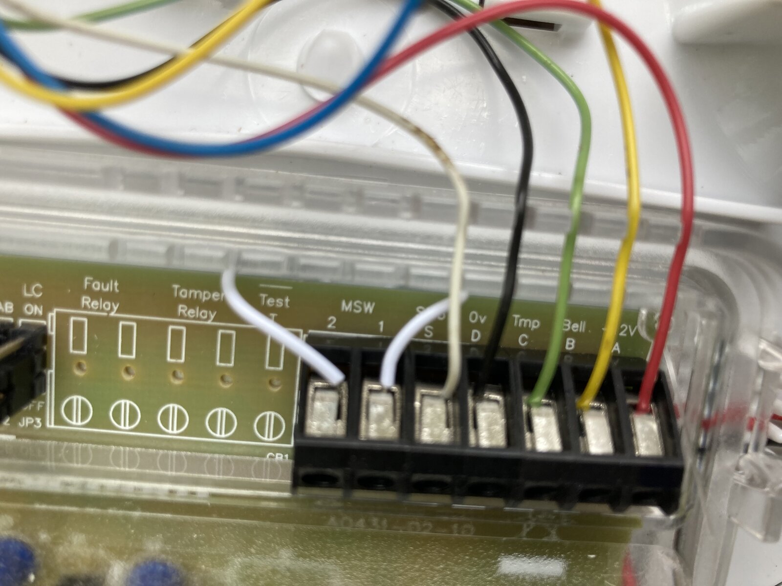

So all PIR's etc fitted and last lap is bell to panel .Bell was previously connected to Gardiner Panel and dont want to blow it at the last lap so before I power up can I ask the experts.
Looks like the same 5 terminal on both the panel and bell.....
See pic of panel and bell box...... confused by the incoming black and red on the panel from new......and the link on the Tamper......
Thanks again.....
Derek
Wire it the same ….remove the link and leave the red speaker wire in with the red wire to the bellbox
