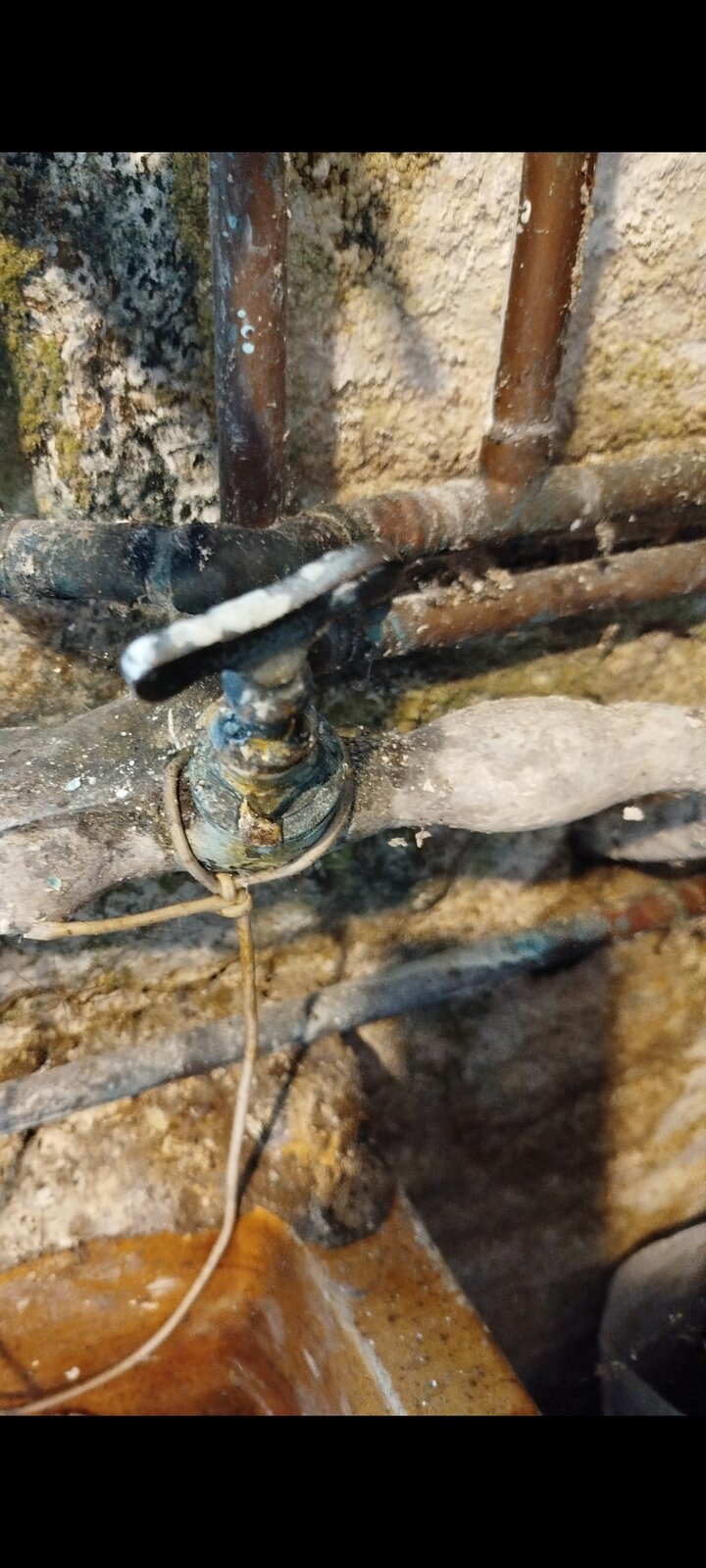

Are universal transition couplings best to attach to lead these days? I need to attach to the lead downstream of this stop tap.

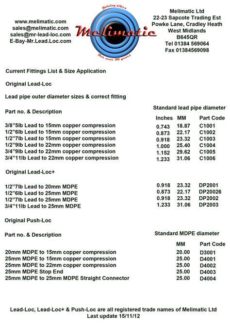

It's a bit of a mine field as lead pipe was made and sold by weight as the gauge.
This link will show you the common sizes that are available.
