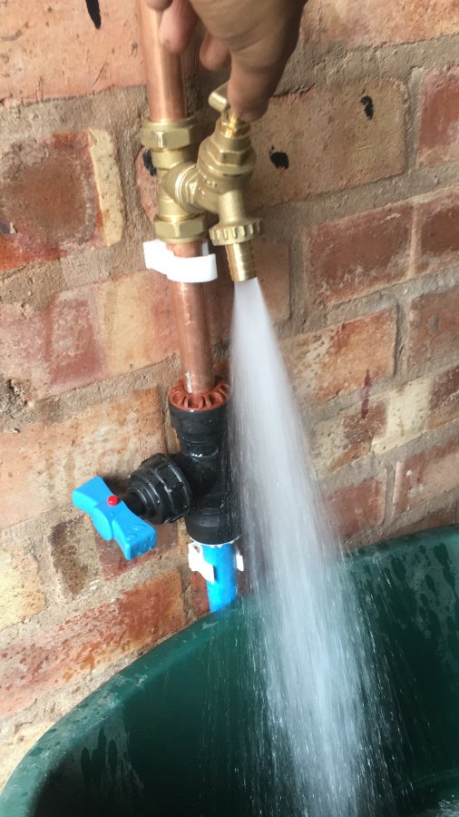

Water board connected new supply pipe- pipe flys off.
It needs that final push to get it through the grab ring as Jackrae mentions. It can be quite firm but it will go.
Ok. It looks like joint slips off and on too easy. I checked the mark and it looks to it needs to go in another 5mm at least and it hasn't slotted in. Is it just more force? I've tried and it's not working. I felt in the fitting and there is a rubber ring inside.
How did you cut the copper tube/ have you de-burred the cut / is the cut square?
Ok I forced it in and it clicked. However there was a few leaks around drain off and compression fittings. Home serve came and fixed them. Bargain.
