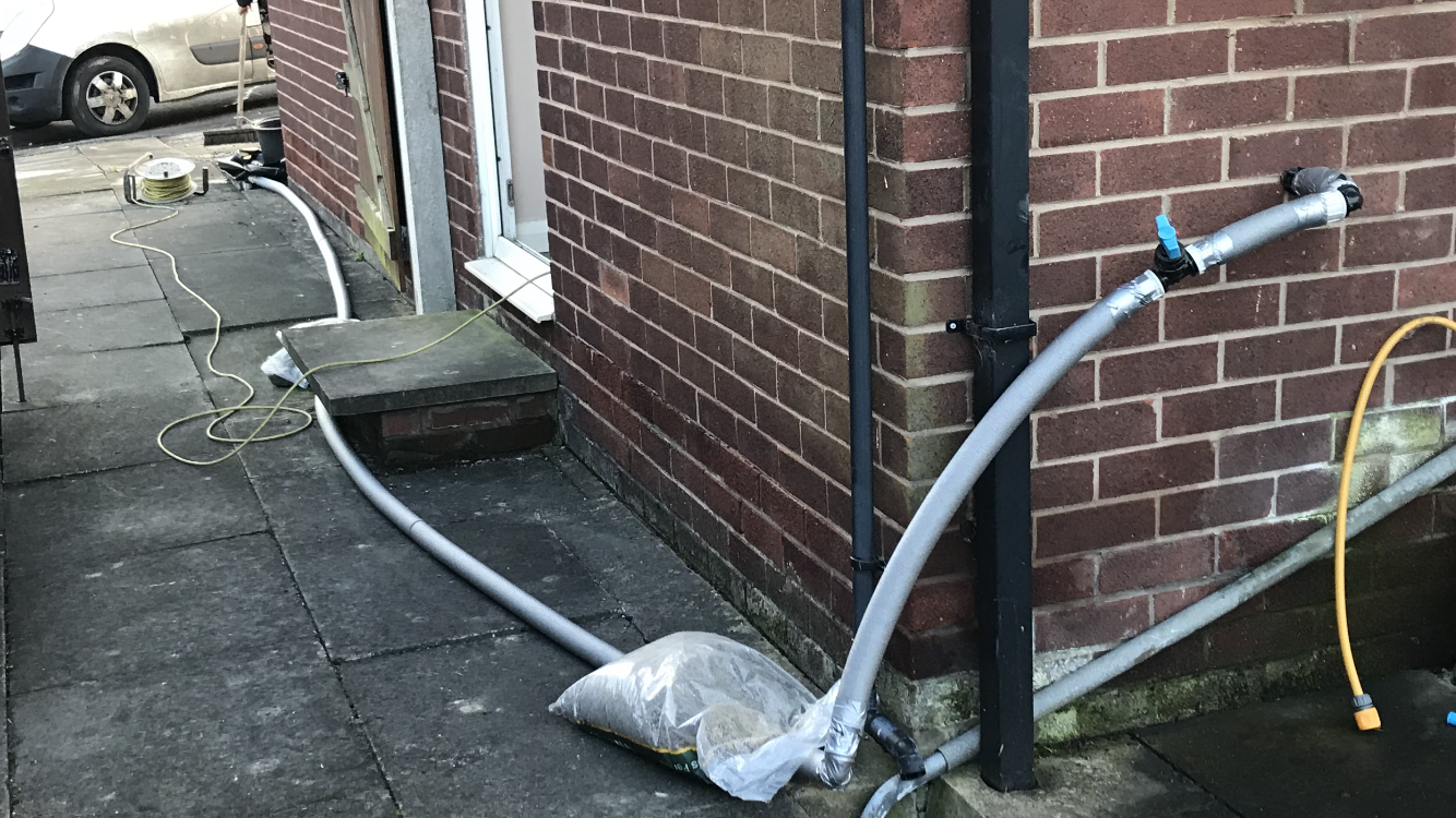

I’m doing a very similar sounding job today. I’ve just dug point of entry, the leak is under the house and it looks like the pipe is in a duct.
This is an insurance job.
Well that was a crap day. The ducting didn’t go all the way so we couldn’t just pull a new piece through. The people had moved out so we temporarily overlanded it so they could move back in.
We are recommending a reroute with Insuduct at the new point of entry.
