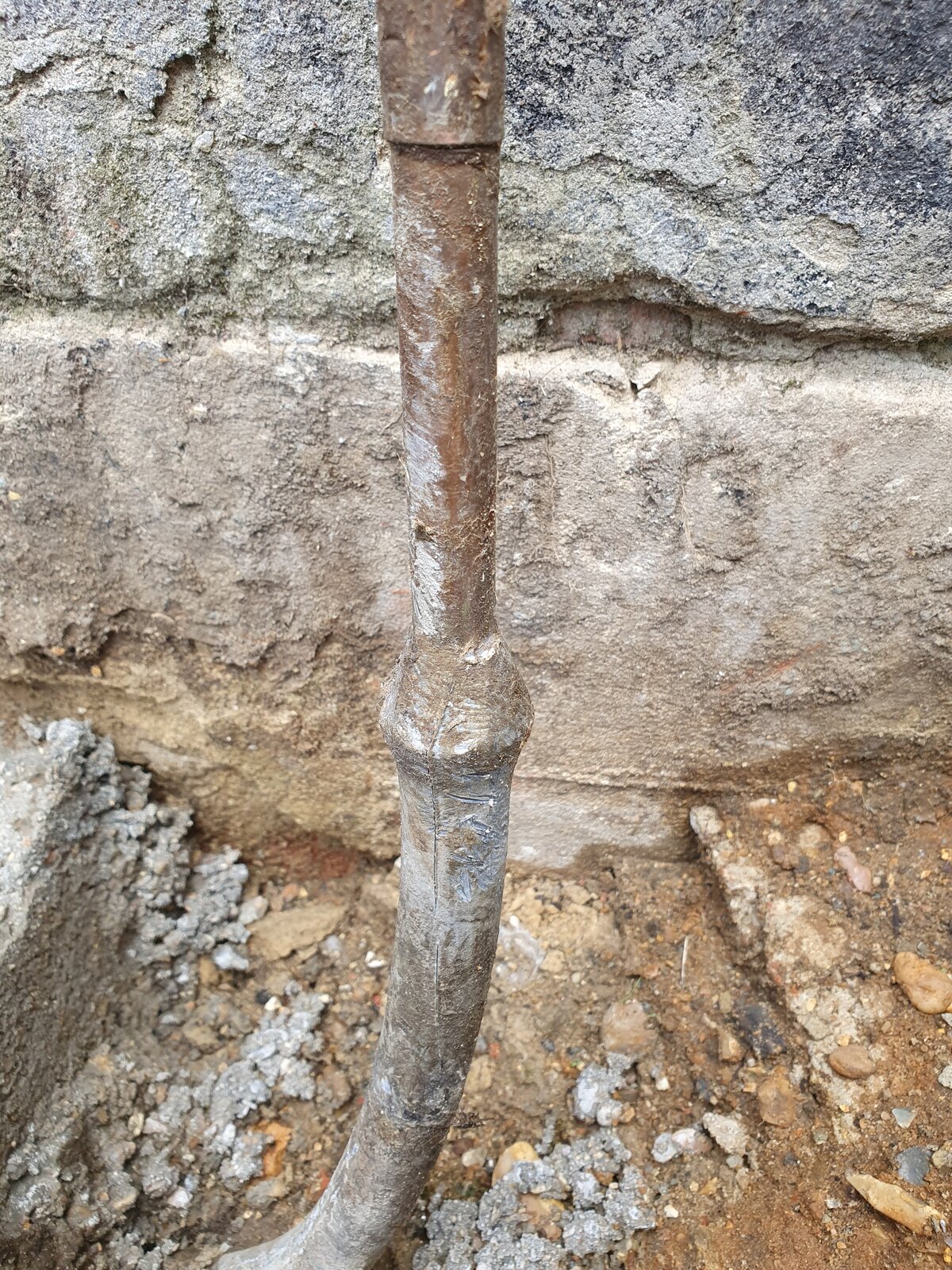

Got an External tap connected to lead pipe and copper just pushed in not even welded or sealed. Not sure how this was not leaking. Now need it to be moved to another location 10m further the garden.
Was thinking to use lead copper adaptor and then use barrier pipe. Can anyone advise if the speedfit works fine on bot copper and plastic or a special joint is required.

As the "copper" end of the fitting is a standard compression fitting, I can see no reason why you shouldn't use JG Speedfit directly into the fitting. The Speedfit pipe should have a pipe insert fitted, and a plain one, NOT the one with extra O rings as they don't have enough depth. Use a copper olive, not a brass one.
Would you use barrier pipe or MDPE for underground pipe as was thinking to extend further and adding second tap which need to go under the garden grass.
Money wise I would prefer just to buy a single longer roll and use for both

Can I trust the joint and attach a barrier pipe to the copper without going from the lead with moder coupler.
That joint is a lip joint and not loaded for strength. You can connect to the copper easily enough but don’t exert a lot of pressure on the wiped joint.
