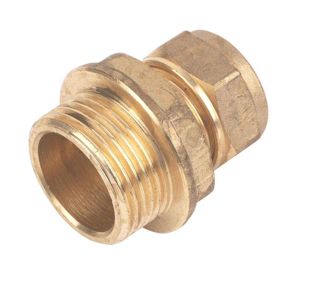

Did you have any kind of washer at the end of your parallel thread or did you just rely on the loctite? The coupler I've got don't have anything like that on them.
Nope - no washer at all although I did consider putting one on.

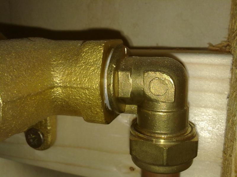

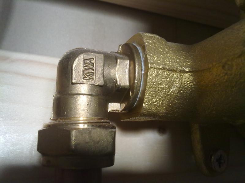

I've attached a couple of photos of how mine turned out after using the Loctite - also bear in mind these are quite shallow male elbows with around 3-4 threads actually inside the shower unit so it was a bit touch and go ....
Looks a very similar situation to mine, I'm gonna try and pick some up before I start connecting up - gotta be the extra cash if it works!
How much did you put on in the end? I'm guessing run it in the grooves for the entire length of the thread, then give it one more layer along the length of the male, and then build it up a bit to form a washer at the back?
Bear in mind I'm not a plumber - just a fairly competent DIY'er
I didn't build it up like you would do with normal PTFE. This Loctite is pretty strange stuff - generally you get better results by cross winding it (watch the video). I put around double the turns that were recommended on the packet.
It certainly seems to do the job and I've not actually come across any negative comments about it other than you don't know how much is left in the tub !
